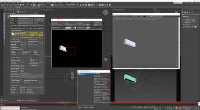

Attached is the max file as well as a screenshot of the issue.
As you can see, the octane preview viewport shows frame 3 and the max render window is also on the 3rd frame. It was set to render the sequence
If I render frame 3 on its own it is fine, only when i render a sequence does it have the issue and only after the first couple of frames

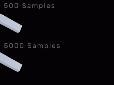

Interesting... the bug seems to also be related to sample count. Higher samples makes it more pronounced. See the GIF below:
I saw this issue first at a much lower sample count but on a much more complex scene, so maybe it's related to "effort" the renderer has to put into the image... A low poly count scene + high sample count is the same as a high poly count scene with a low sample count... maybe
