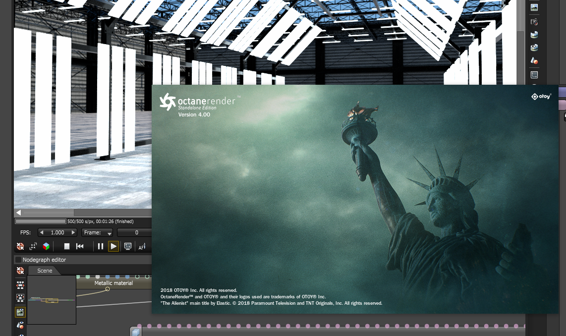

Do you know if the Standalone V4 XB3 works on this system? Perhaps you have a problem related to outdated drivers or something like that. You can download the Standalone here:
viewtopic.php?f=33&t=67790
If this Octane V4 Standalone works fine, perhaps the problem is related to a mistake in any of the houdini.env PATH variable characters, but let's check first if your Octane 4 works fine on your system. If the Standalone doesn't work, please update your NVIDIA drivers to the latest ones available.

thanks for reply. Octane V4 Standalone works fine on my system. and I think houdini.env PATH variable is fine too. because Octane_3.08.1.0_Houdini_16.5.496_Win64 is worked fine.
