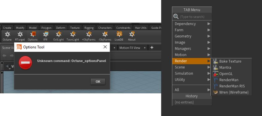

I can‘t add Octane in out, and Octane 3.08.1.0 is worked fine.
i add this in houdini.env
Code: Select all
PATH = "$PATH;C:/Octane_Houdini_Win64/Octane_4.00.0.8_Houdini_16.5.496_Win64/bin"
HOUDINI_PATH = "C:/Octane_Houdini_Win64/Octane_4.00.0.8_Houdini_16.5.496_Win64;&"

I add 'HOUDINI_DSO_ERROR = 2' to houdini.env file. and says that.

David_DK if you don't mind I join to the topic. I have the same situation, but in my case probably everything is fine in the houdini.env.
Maybe Juanjagon has a solution for my problem.
My houdini.env Look's like this:
PATH = "C:/ProgramData/Redshift/bin; c:/Users/Cr_Pc/Documents/Octane/Octane_4.00.0.8_Houdini_16.5.496_Win64/bin;$PATH"
HOUDINI_PATH = "C:/ProgramData/Redshift/Plugins/Houdini/16.5.496; c:/Users/Cr_Pc/Documents/Octane/Octane_4.00.0.8_Houdini_16.5.496_Win64;&"
I have exactly the same error on the start. Standalone working.

Can you please remove the space character that you have just after the semicolon, between the two plugin paths?
