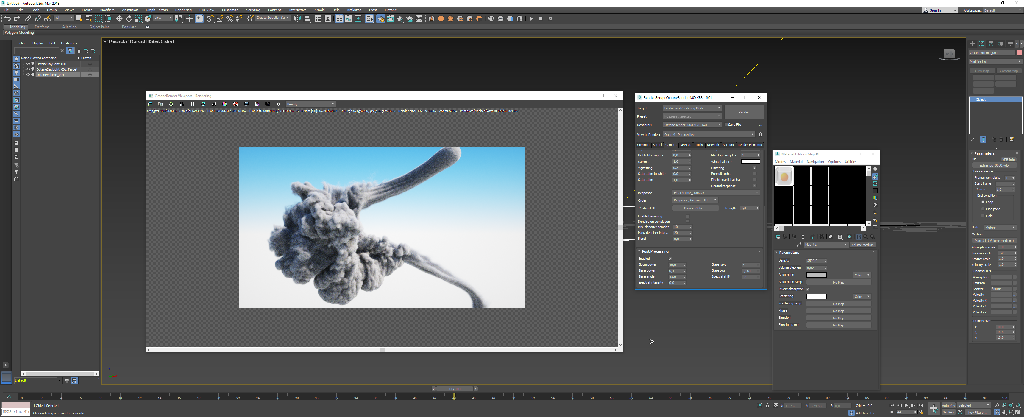

yes ... really strange this is the octane view with exact same vdb ! work really well ! and its a really common problem i have with vdb ! all my fire is rendered with 3dsmax version of octane because the c4d one don"t find the channel !
