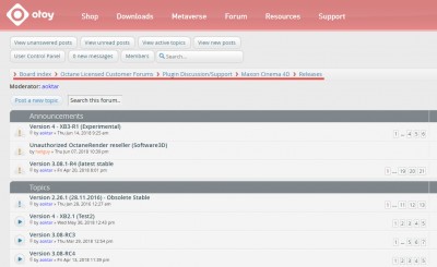

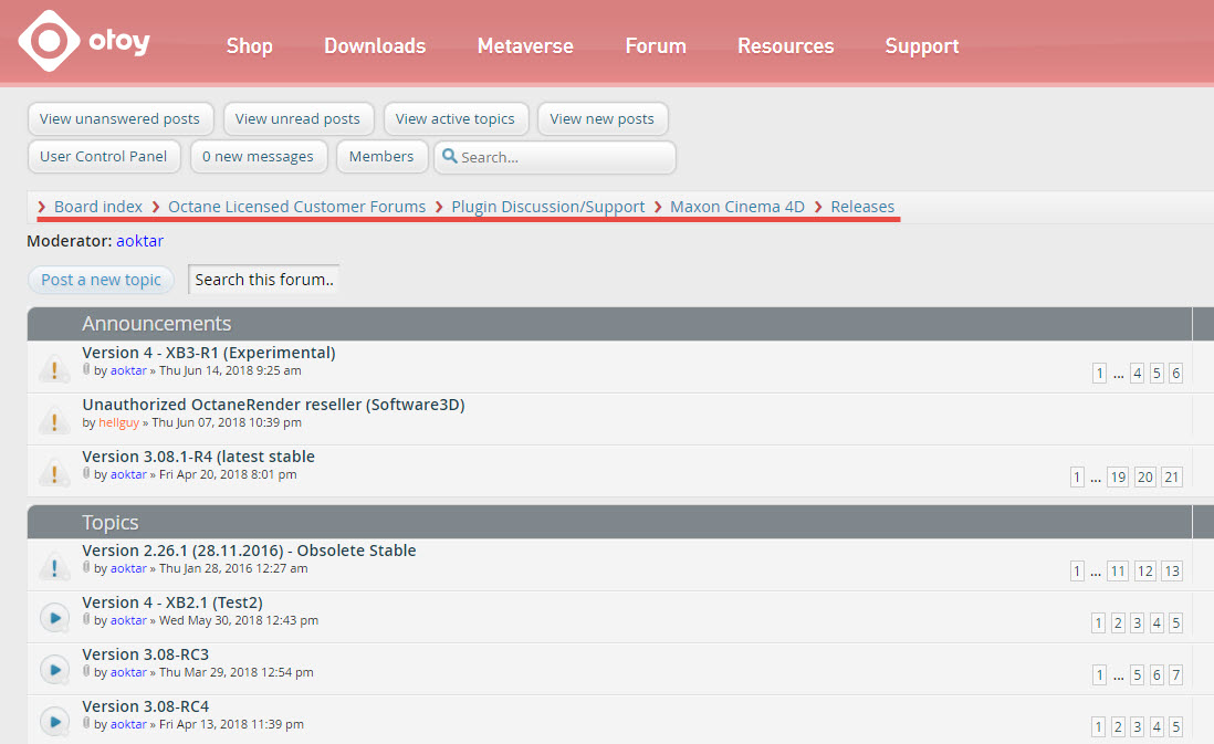

Latest builds are always here
And 3.08.1-R4 here: viewtopic.php?f=85&t=66885

Thanks again for replying aoktar.
I did eventually find that post. Sorry I'm still pretty new to Octane and this forum.
So I installed v3.08.1 R1 through to R4. And whilst R4 seemed a little more stable it still crashes.
