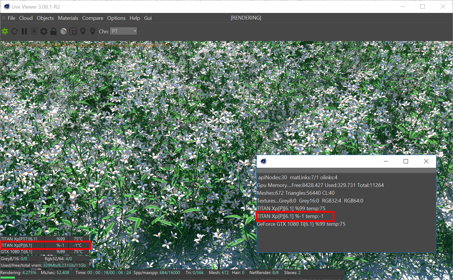

Wrong Reports - GPU Usage, Temperature....
I have no problems using Octane, but I report a bug.
This problem has persisted for a long time.
System Configuration
ASRock Fatal1ty X399 / Ryzen 1950x / 64Gb Ram / Titan Xp x 2 / 1080 Ti x 1 / Win 10
I am using Titan Xp in TCC mode(Like Tesla).
The problem occurs when use "TCC" Mode.
Take a look at the picture.
Second Titan Xp Usage -1%, Temperature -1

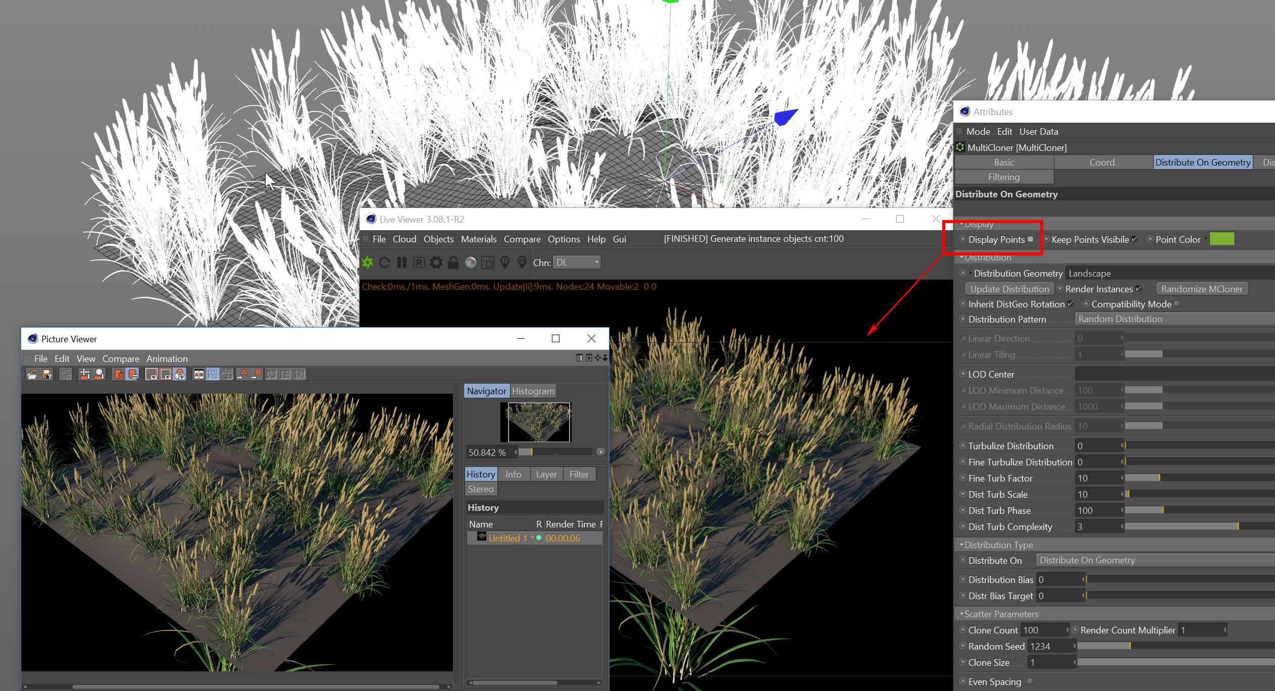

Two more things that need fixing (i guess are already known from other users feedback) :
a) glossy icon is same as specular icon
b) vdbs dont show correct in viewport (see image below)
