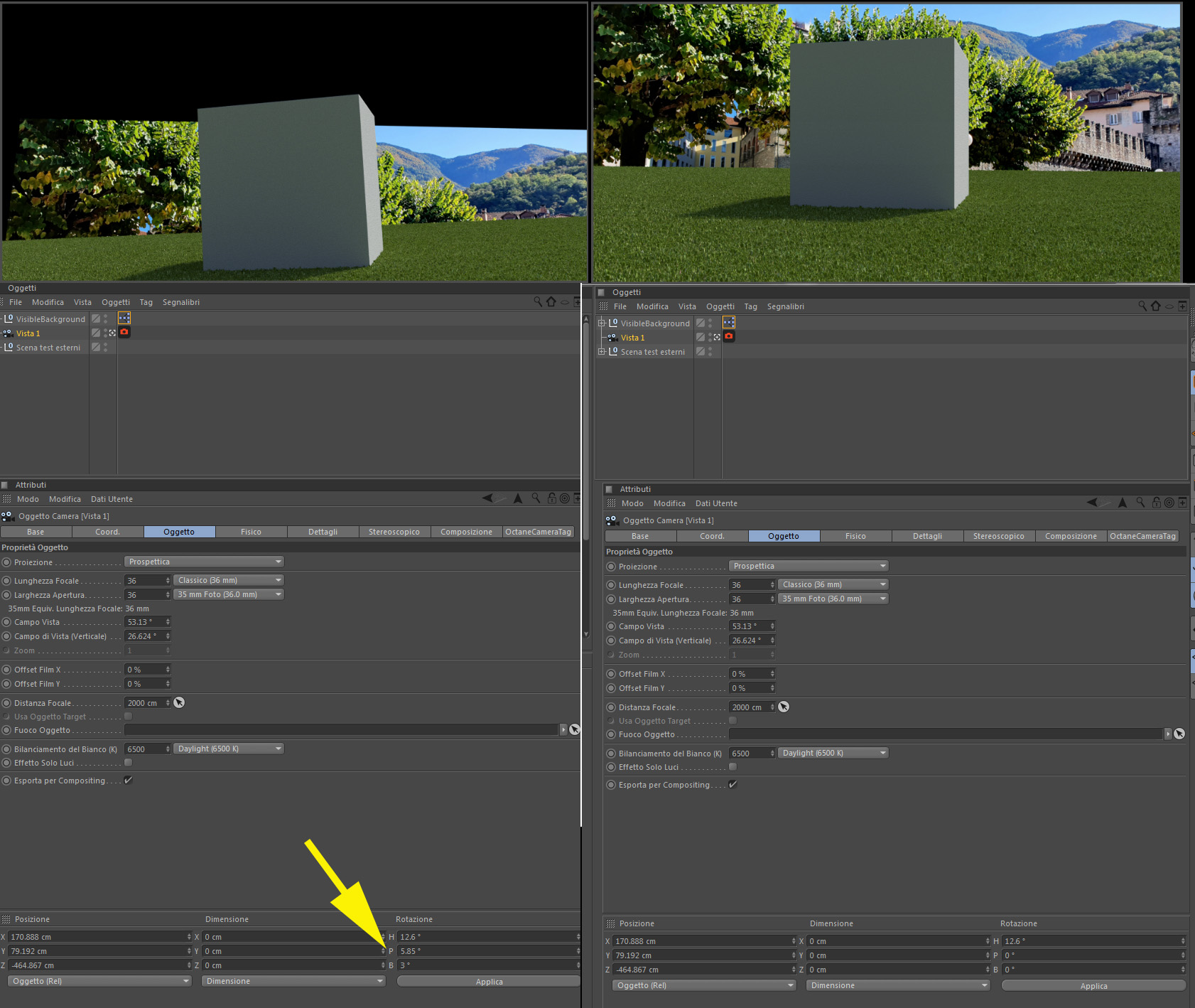

I ask if is possible to solve in some way (perhaps my fault) the situation when you can't have a Camera not tilted because in this case the background image don't fit the screen.
There is a simple workaround?
Thanks again for your help.

Hi dear Beppe!! How are you??
Please check if you see the problem rotating the camera angle "P" to +5° (positive).
Thanks again.
Luca

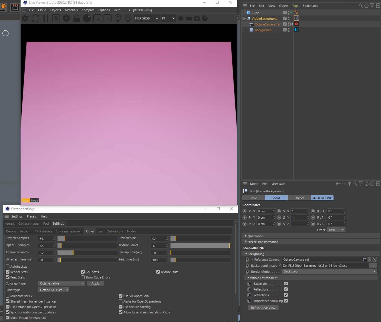

Thank you for this Beppe! It's great, but I am having the same issue as Luca. The plane is not following P rotation (H and B work as expected).
Posts: 10637
Sorry, so many things, and it is a long time that I don’t check this, but I think we have solved with Luca by using the following cameraMap_environment.osl script by Calus:
viewtopic.php?f=21&t=65575
Please Luca, help me remember this :D
