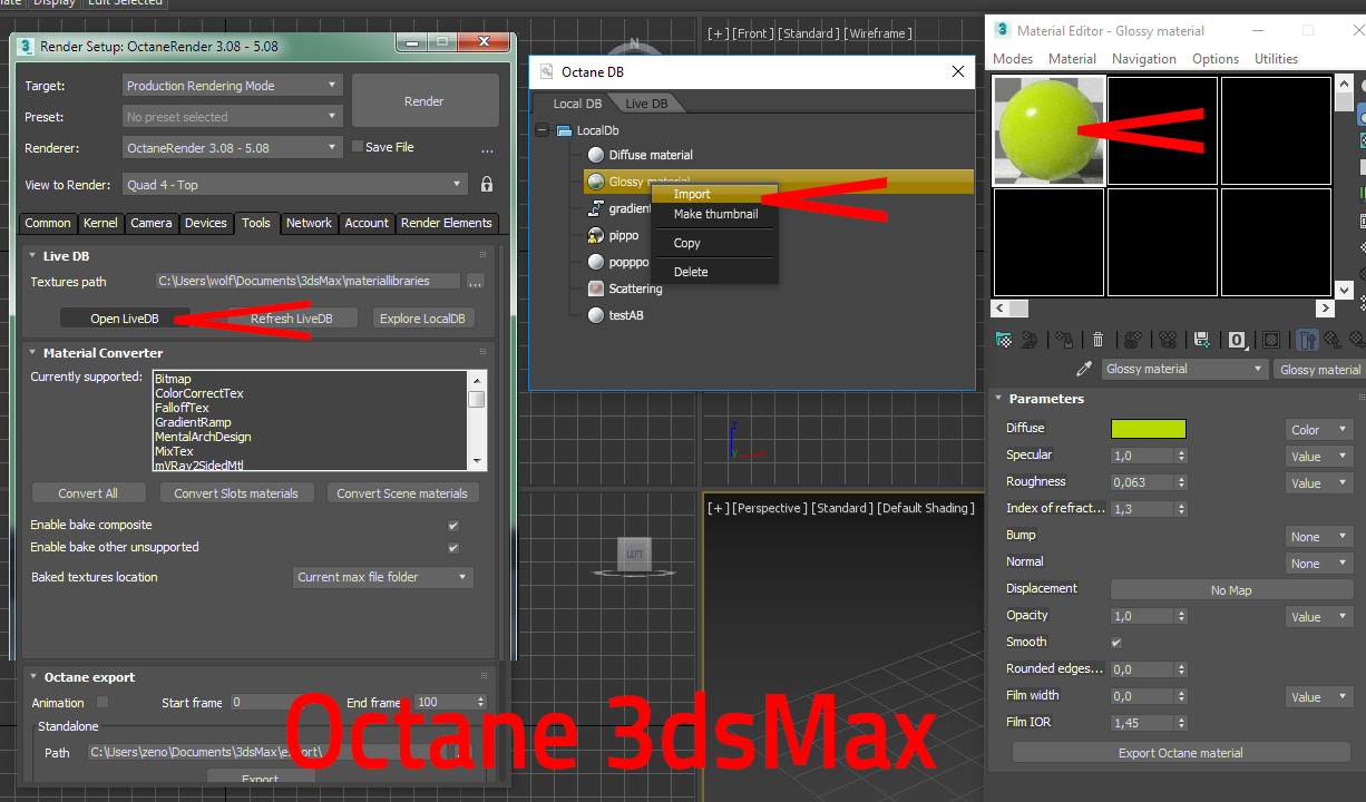

Hi MDFutm,
you should to save your Octane materials in Octane LocalDB folder (C:\Documents and Settings\(your account name)\AppData\Roaming\OctaneRender\localDb), then import them into 3dsMax material editor.
