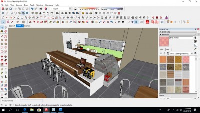

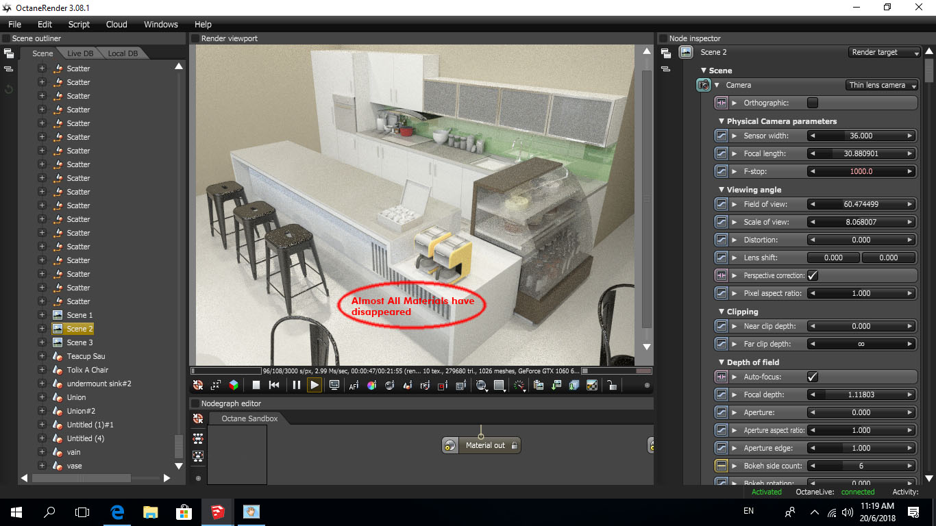

Hi, I've attached a sample below. I've to redo the material assigning again and again.
But then, I've just realised it was when I modified or make changes to the sketchup file, the settings in octane will reset to default.
