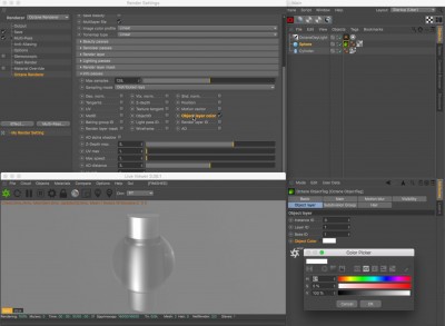

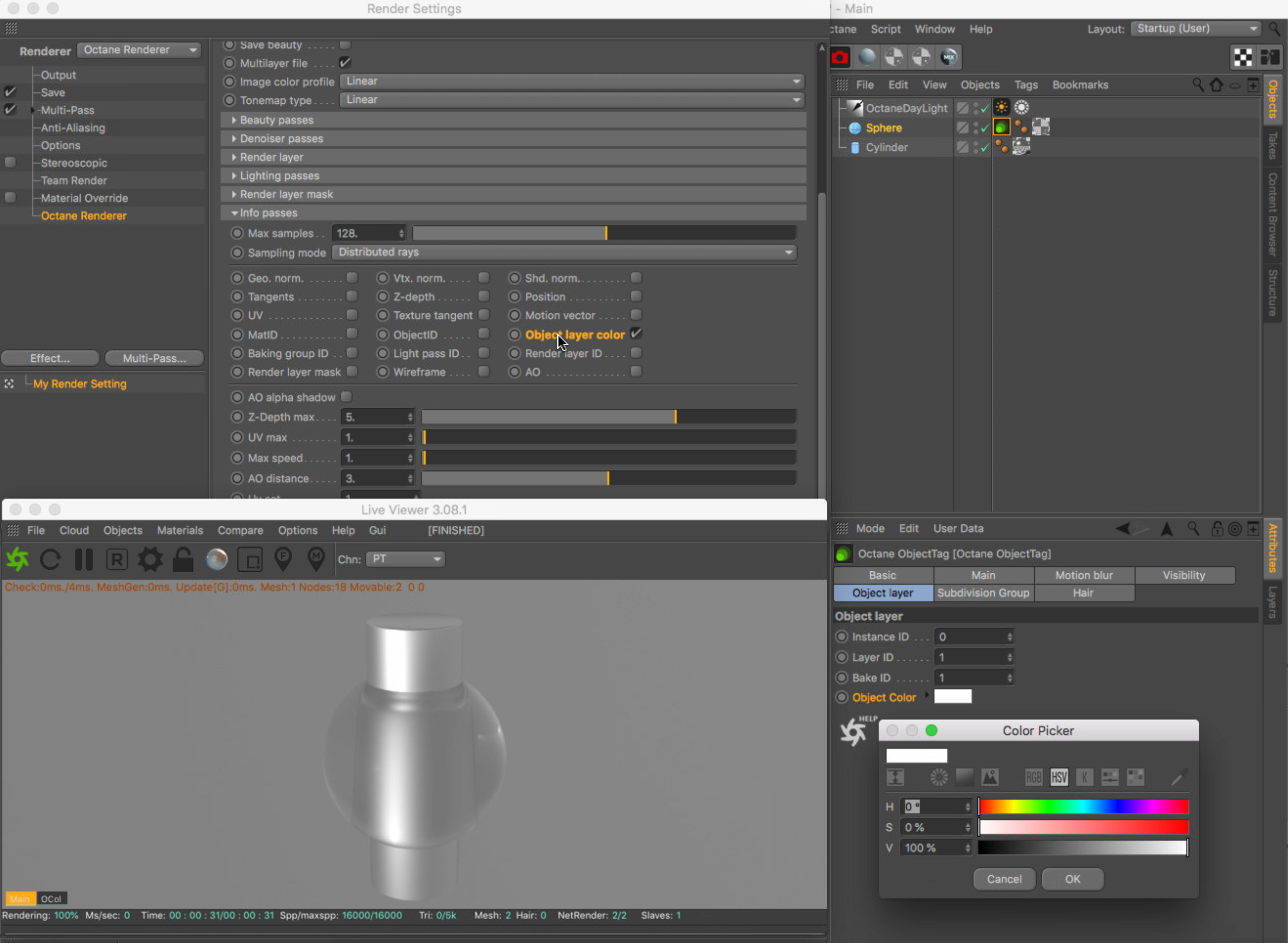

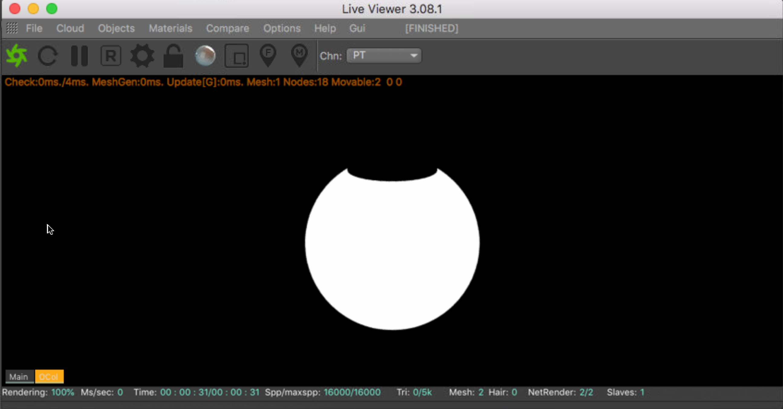

add an Octane Object tag, change the Object color from black to white in the Object Layer tab, and enable the Object layer Color pass in the Render Settings/Render Passes tab:
in this way you can have a solid mask of any kind of object, with the desired color:
ciao Beppe

That's brilliant!
Thank You!
