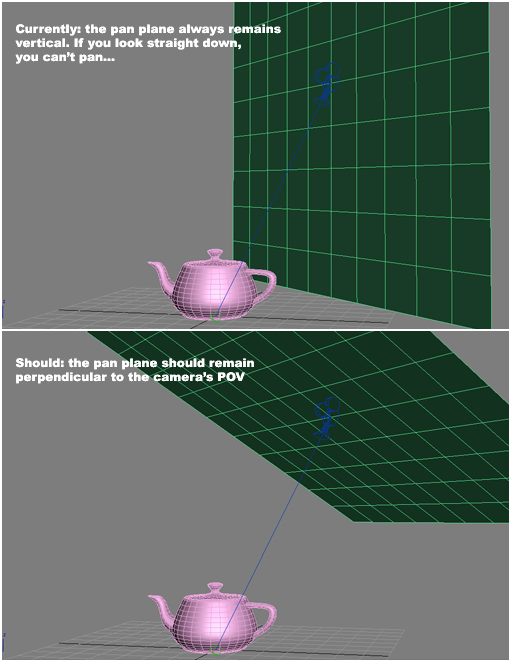

My biggest concern has been discussed before, so just making sure this is noted: you can't pan properly, specially when looking straight up/down, because atm the pan plane always remains vertical.

Well, I like how the cam is implemented in Blender.

* panning (should be in the plane perpendicular to the viewing vector, as Proupin pointed out) also translates the center of rotation for the same amount
This is the 'trackball' behavior in Blender.
I actually don't care from which program the cam behavior is imitated, just get rid of gimbal lock or "hidden walls"
