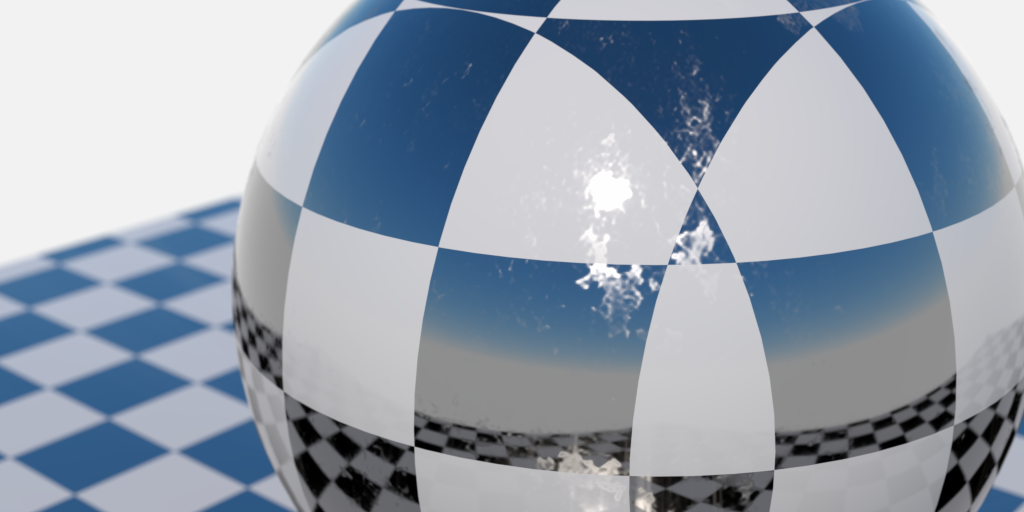

Roeland posted a proper metallic workflow material that has 'diffuse' sections that are glossy with a 1.4 IOR so that roughness maps affect those areas of the spec map.
Is there a plan to implement this in the plugin soon?
I've attached the .orbx from Roeland.
Adding proper metallic workflow material

The roughness values should affect the diffuse areas as if they were a glossy material with an IOR of 1.4. That's what the material that I attached in the previous post does. It was made by a core Octane dev. No mix materials. All in the metallic.

So it should look like this.
My understanding was this is supposed to end up as the default, out of the box behavior of the metallic material. No mix material workarounds as in the attached graph or the substance bridge.
Having to use a mix material for every object in a scene textured with a basic PBR workflow really slows things down. Every other engine can do it with a standard material.
