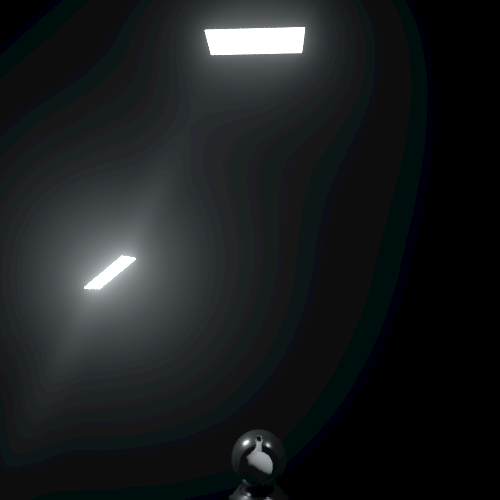

recently i upgraded the newest octane 3.08 RC4 - 12.27 plugin in maya,after a few test render i got this weird result
i tried everything i could think of but it won't help,anyone knows how can i fix this situation?
thanks~ ;)

In the Octane camera, go into Imager and make sure you are not using any film response (set it to Linear/Off), and then set the gamma to 2.2.
When you render in the IPR window, make sure you change the output from SRGB (the default one) to RAW.

thank you rikk.it works!
