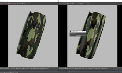

Sure thing Paul.
So here it is:
The one on the left is just rendering a still. The one on the right is after I clicked "render animation".
The difference is in the very, very low displacement value on the right. For some reason Octane changes it when rendering an animation. When I pause the animation, go into material settings and set the displacement much higher (like 0.5) I get a similar result as the image on the left.
I'm assuming the reason for this is that Octane has changed the displacement node somehow?

I am missing too many textures to be able to test the scene you sent me. If you can provide all the textures, I can take a closer look.So here it is:
