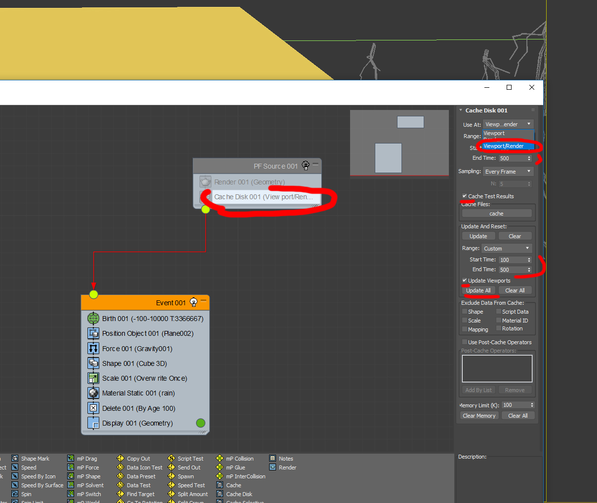

acc24ex wrote:
coilbook wrote:
acc24ex wrote: with pflow I definitely recommend adding cache event right bellow the render in pflow source. Helped me a lot with animation.
.. gonna check it, thanks, where do you add that..
..another bug, probably from before, I'm working in production now, so I'll report what I find:
- apparently when you copy an movebale proxy instance, you have to refresh the viewport, when you instance an instance it's ok - also when enabling renderable or no renderable also needs a refresh of viewport - anyone else got that ..
Here is the screenshot for pflow cache

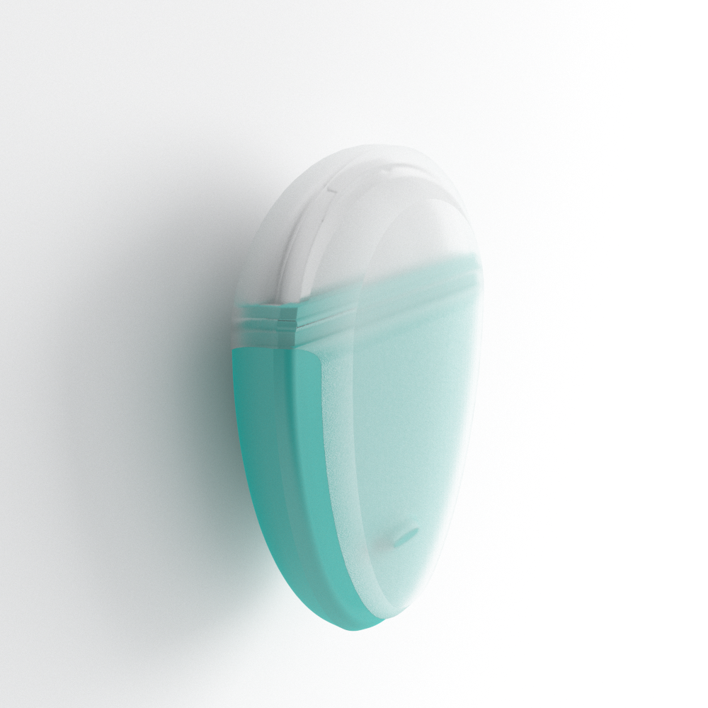

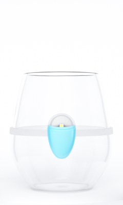

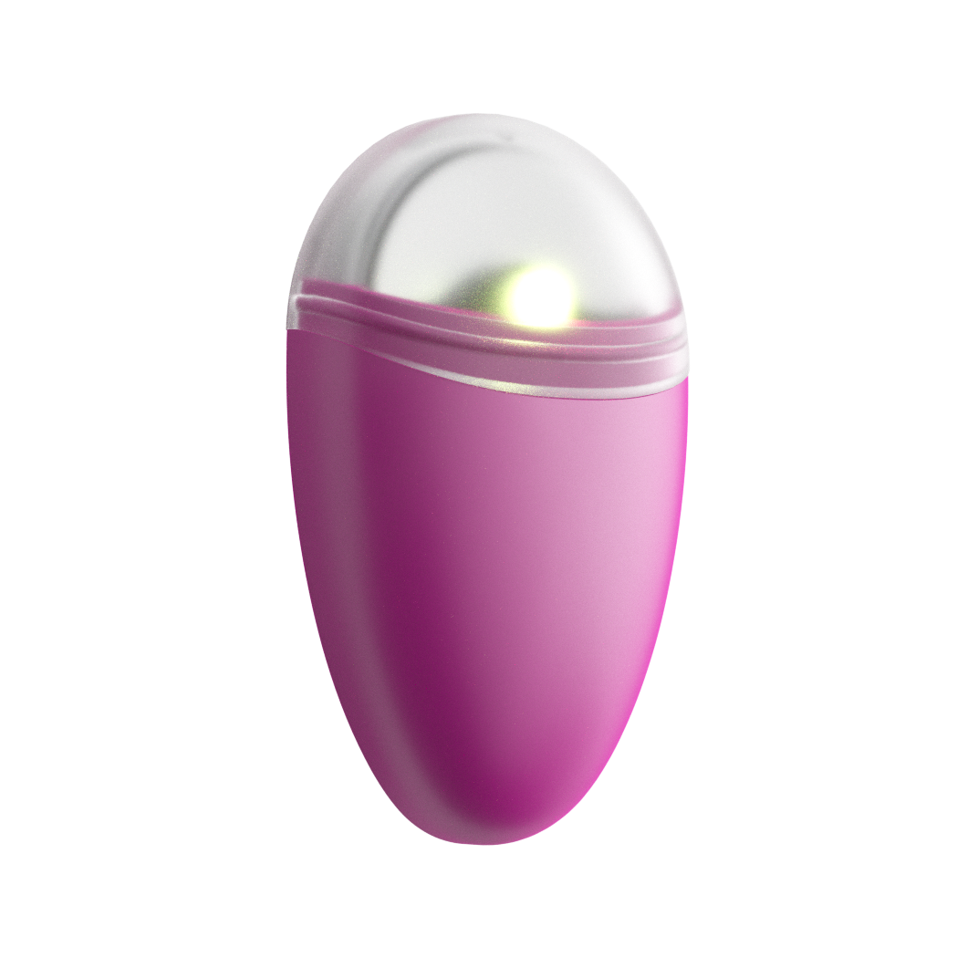

Some WIP..
I like the solo render, but I'm having trouble with the glass, need more reflection on the edges, the very thin outer edge is difficult to control - any advice on those
..other than the bugs posted, pretty solid build, some older bugs fixed, stable, been rendering 4 hours, no crashes, spins perfectly with a smaller projects

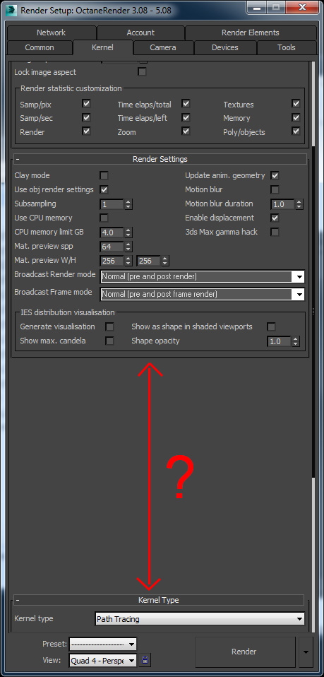

Is it just with me or there is a gap between rollouts on the latest version (see attached image)?
using octane since the dawn of the dinosaurs :)

muski wrote:Is it just with me or there is a gap between rollouts on the latest version (see attached image)?
That seems to appear only on max2015 and previous, after changing the Kernel type. The work around is to close and re open the Render Setup dialog.
This will be fixed in the next release.
