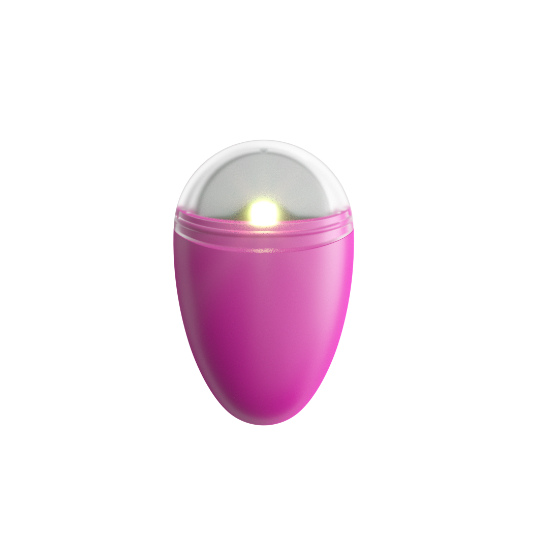

acc24ex
Posts: 1481
Joined: Fri Mar 19, 2010 10:58 pm
Location: Croatia

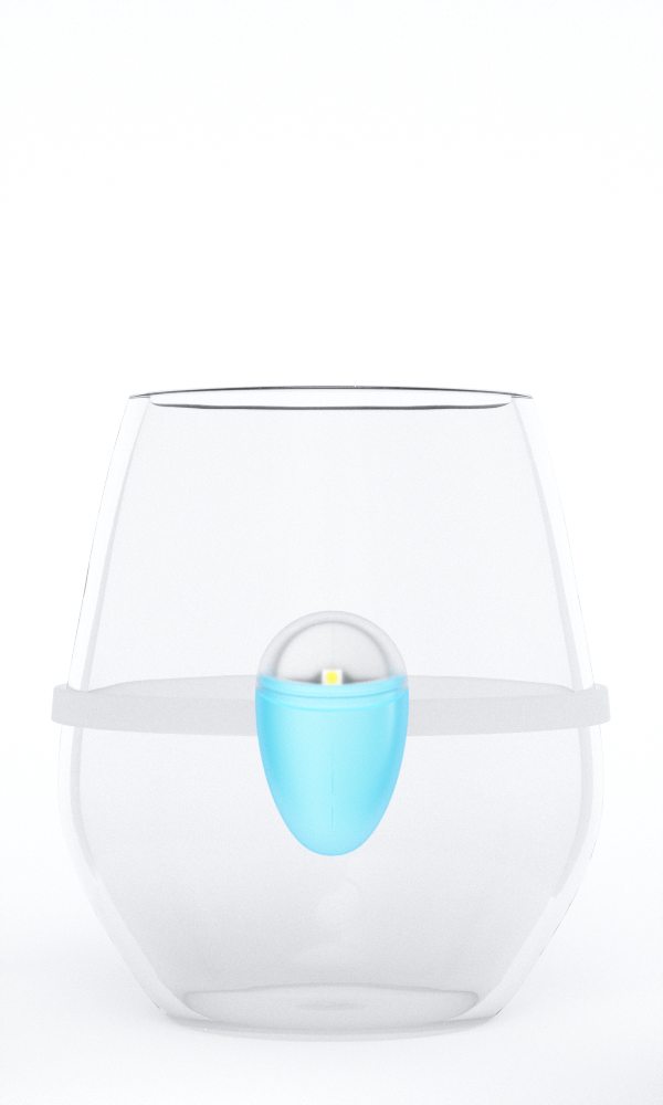

Some WIP..
I like the solo render, but I'm having trouble with the glass, need more reflection on the edges, the very thin outer edge is difficult to control - any advice on those
..other than the bugs posted, pretty solid build, some older bugs fixed, stable, been rendering 4 hours, no crashes, spins perfectly with a smaller projects
