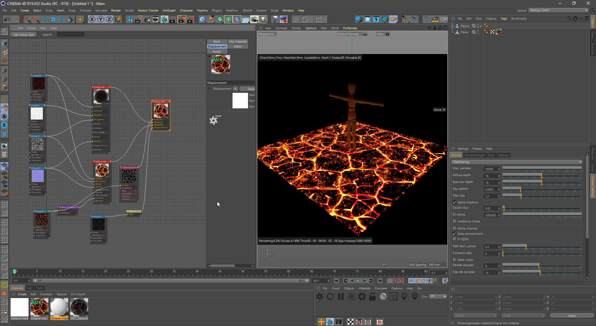

Hi guys, I've been developing a live link between Substance Painter and multiple apps (modo, c4d, Houdini, maya, 3ds max, blender) and multiple renderers (vray, corona, Arnold, redshift,cycles... etc) but one of the most relevant was missing! Octane, finally after help and support from Otoy, I finally was able to implement it, and I started with the cinema 4d version, since is the one I received more requests...
anyway, long story short, here is a sneak peek, hopefully soon, i'll be able to integrate it in the other apps,
i'll share it here once is available
Substance Painter + Octane + C4D Live Link

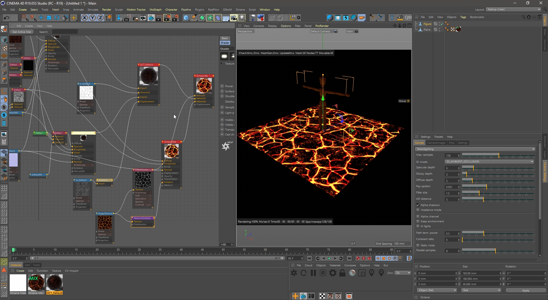

I have two ways and one with the universal material that I'm not sure yet
Use the link, then put it in the material 01 of a mix material, in the material 02 a diffuse octane one with all the maps plugged in and the emmisive desaturated and color corrected as a mask. also move the displacement to the mix material. (very convoluted)
or in the blend add a new material and do the same, emmisive, desaturated/color corrected as a mask with all the maps plugged and in diffuse mode. the displacement works better with this
remember to change the brdf to ggx to be more or less similar on how metallic PBR works
using the universal material as advertised is suposedly a 1:1 with the metallic maps but the results differ a lot.
The mos accurate one for me is the one only using the blend material generated by the link and adding the emmisive channel manually
