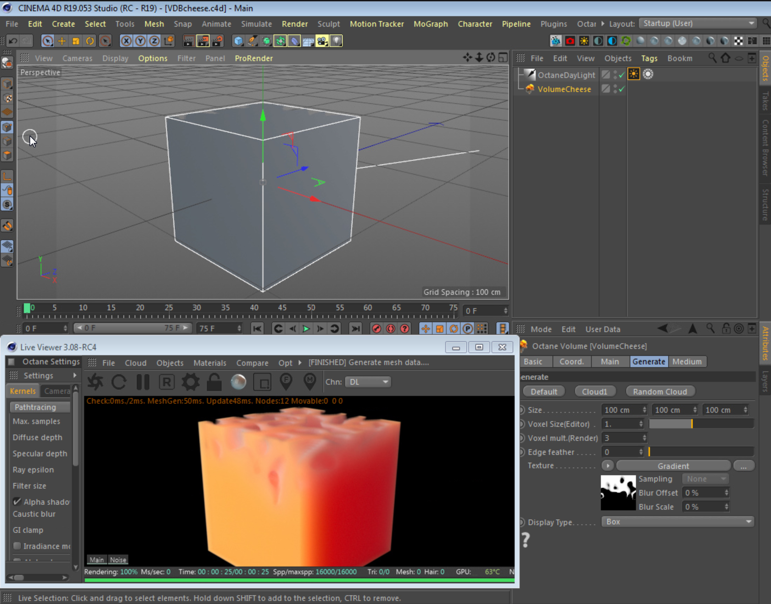

Hi Chris,
you cannot use shaders in the medium node, but you can generate the volume with noise or other shaders, have a look at this example as a starting point:
vdbcheese.zip
(66.58 KiB) Downloaded 132 times
ciao Beppe

Thanks bepeg4d!
I figured that would be the case. Your example is great but it's not quite what I needed as I was hoping to apply the effect to various models, not just a cube or sphere. Oh well, onwards and upwards!
