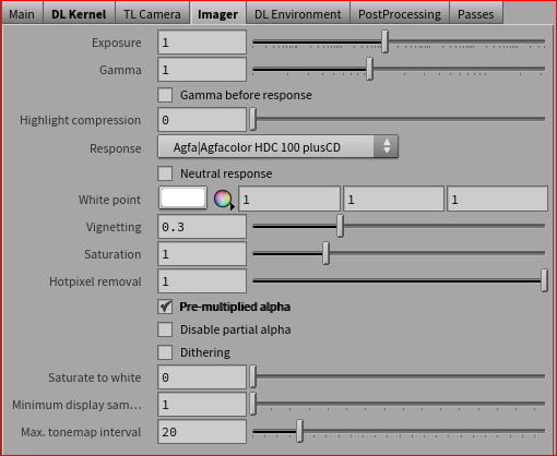

i think it is because you are watching an unpremultiply image.
this mean that if you don't want to see that noise you have to check the pre-multiplied alpha image option in your render target settings.
with that option check R G B channel will be multiply by Alpha, and thus giving a smooth aliasing.

perfect, that worked. Thanks a lot!
