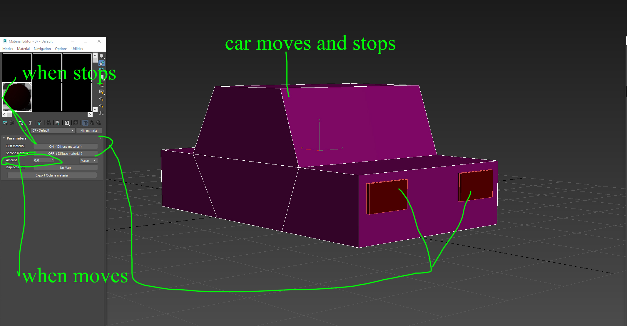

I know it is a bit off topic but anyway to do a float script or use parameter dialog to control octane's mix material amount with actual car speed. If car stops/slows down mix amount go to 1. Car starts moving mix amount goes to 0. I appreciate any help.

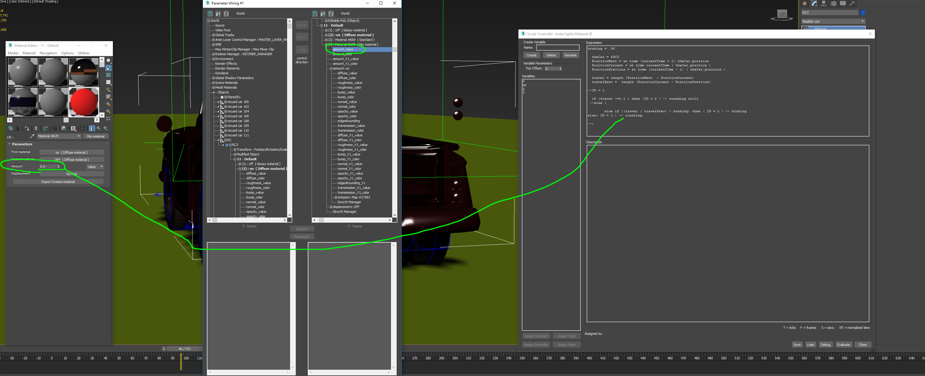

it looks like this float script work with changing material ID 1-2 when car stops and goes If anyone know how to change mix material amount instead of ID 1-2 will be great
braking = .96
theCar = $RC3
PositionNext = at time (currentTime + 1) theCar.position
PositionCurrent = at time currentTime ( theCar.position )
PositionPrevious = at time (currentTime - 1) ( theCar.position )
travel = length (PositionNext - PositionCurrent)
travelPrev = length (PositionCurrent - PositionPrevious)
--ID = 1
if (travel <=0.1 ) then (ID = 2 ) -- standing still
--else (
else if ((travel / travelPrev) < braking) then ( ID = 2 ) -- braking
else( ID = 1 ) -- coasting
