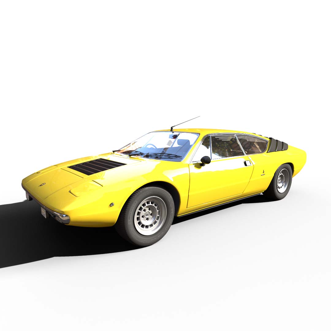

Images look different compared to Version 14 (I've tried various settings without success)
Blender Version 14
Blender Version 15.1
