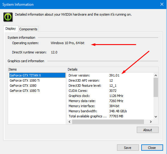

I have TitanX (Maxwell), 1080Ti and 1080 in same machine and no problems, I use octane standalone, Adobe CC package and LightWave+Octane so no problems with mixed GPUs.
Have you tired changing nvidia driver revisions ?

Mine is 391.01

Hi lilsmokie,
I think your issue depends on Nvidia drivers you installed.
Good stable one Nvidia 388.13
http://www.nvidia.com/download/driverRe ... px/126255/
Performed clean installation procedure using Download Display Driver Uninstaller DDU
http://www.guru3d.com/files-details/dis ... nload.html

So I have been picking at this for awhile and I think I came across something fairly obvious. I had a program called Mac drive and Duet display installed on my system. I uninstalled them both. I am hoping the problem is not Mac Drive, I think it might have been Duet Display.
It is a bummer to uninstall it and not be able to use it. I dig drawing on my pc with it. But it has its own weird display trickery it uses to get the iPad to read as a display. Haven’t used it in awhile tho, totally forgot it was there.
Thanks everyone for your help.
Hopefully this was it!
