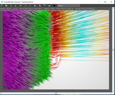

Hi Stir,
attached hair and fur with spline and geometry using gradient texture node.
Maybe I'm wrong workflow, I did a lot of tests but I can not handle W coordinates.
It looks like Octane Render does not read hair and fur UVW map and hair and fur does not seem to assign UVW map either by exporting to .abc or polygons.
I will try to solve the issue by talking to developers.
Regards
Paride
Regards
Paride
