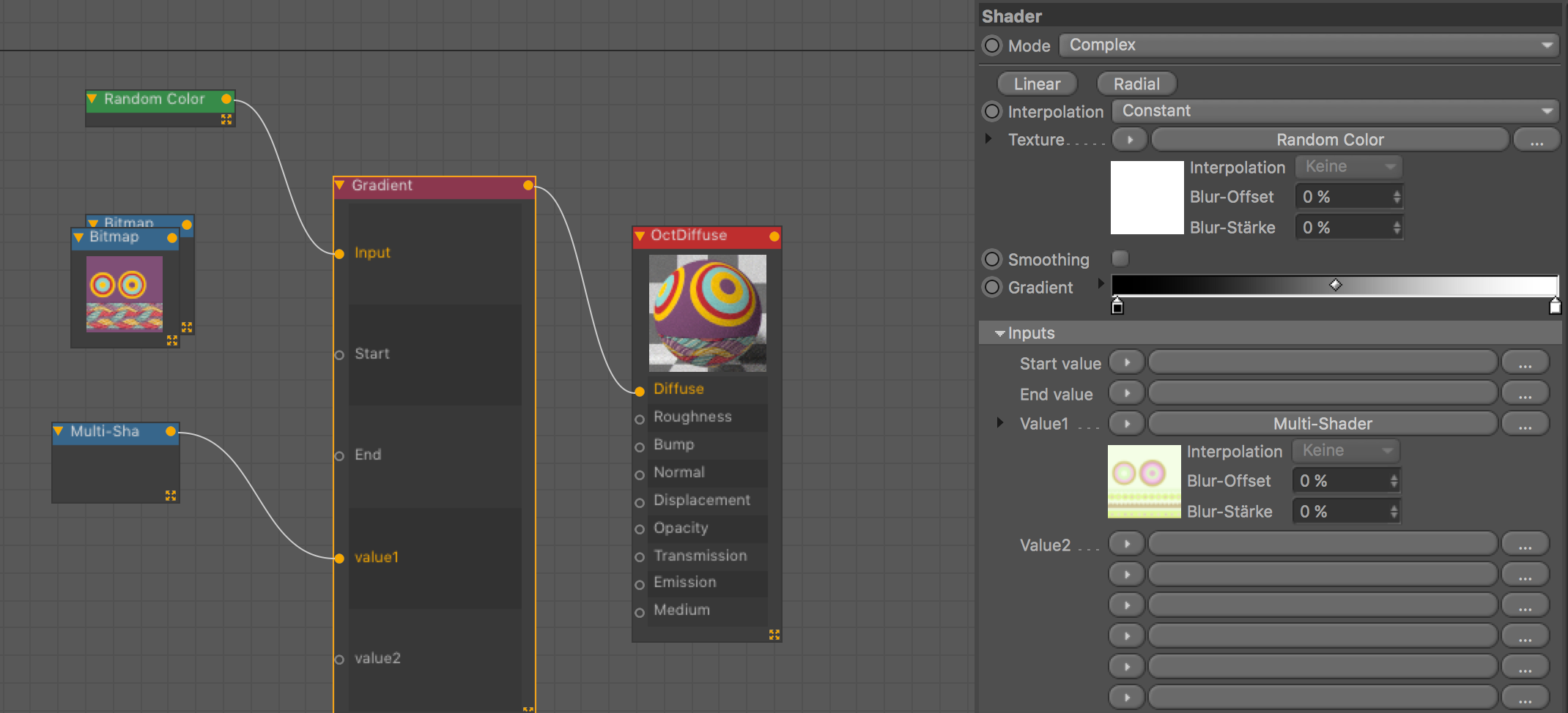

sorry, i don't know how to connect the gradient mapper to the multi shader and diffuse output, could you be more specific ?

I tried this, but didn't get it working, changing the seed at the random color shader doesn't change anything, what am i missing ?bepeg4d wrote:Hi Fabian,

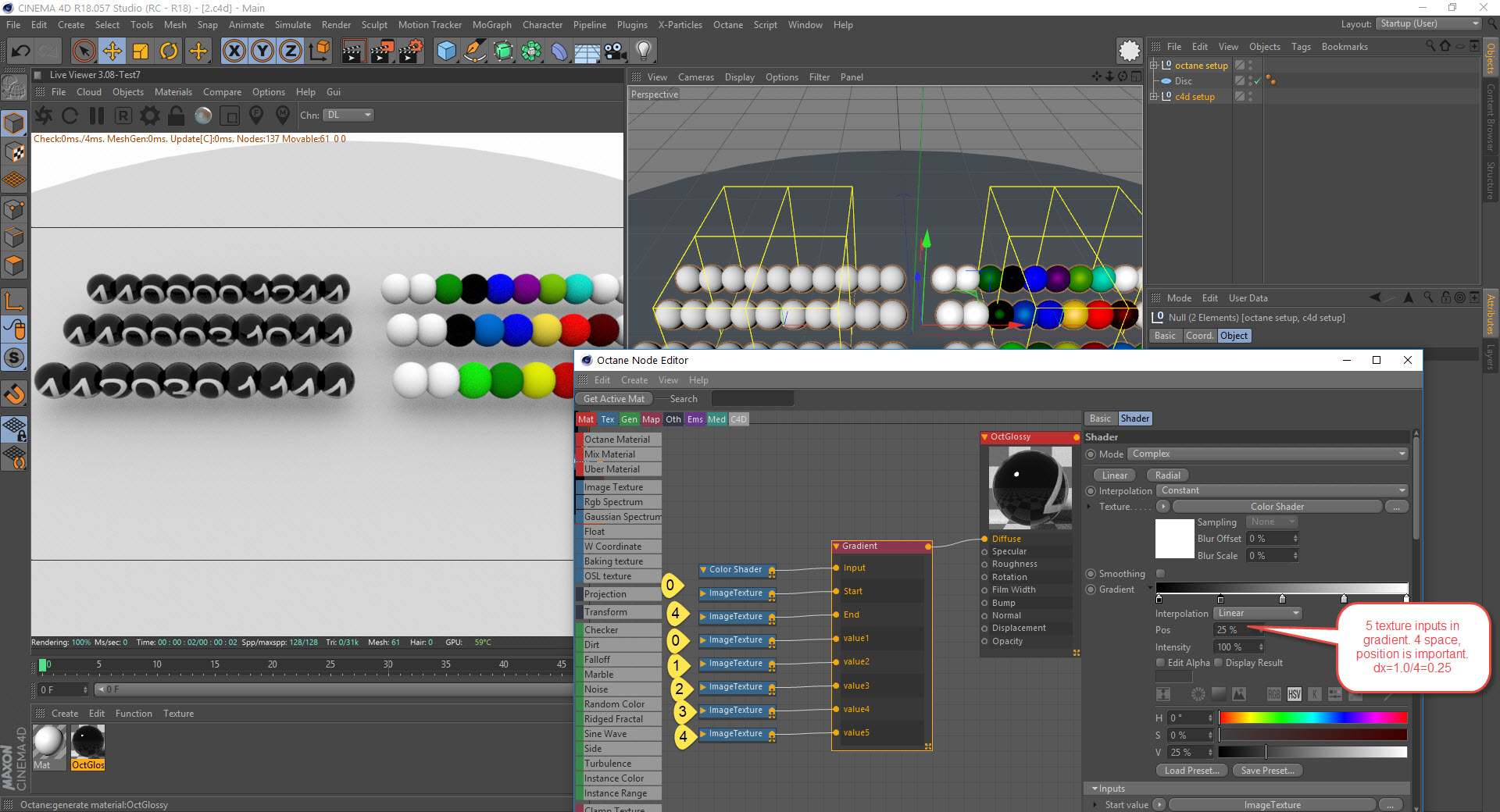

see
- Attachments
- grad1.rar
- (162.36 KiB) Downloaded 270 times
yes i know that, but where is the multi shader node ? this it what this thread is all about ..aoktar wrote:see
Fabian
You missed this message?fabian19 wrote:yes i know that, but where is the multi shader node ? this it what this thread is all about ..aoktar wrote:seeI need to connect like 50 different textures and want to use the multi shader, which works in generell, but not all textures are used. Thanks for all your effort.
