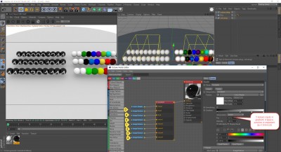

I tried this, but didn't get it working, changing the seed at the random color shader doesn't change anything, what am i missing ?

see
grad1.rar
(162.36 KiB) Downloaded 226 times

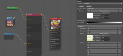

aoktar wrote:see
yes i know that, but where is the multi shader node ? this it what this thread is all about .. :-) I need to connect like 50 different textures and want to use the multi shader, which works in generell, but not all textures are used. Thanks for all your effort.

fabian19 wrote:
aoktar wrote:see
Fabian
You missed this message?
viewtopic.php?f=30&t=62583#p331251
This is alternative way because of this reason from post.
