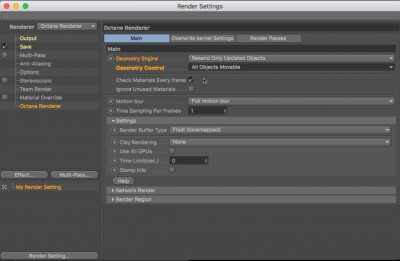

in LV you can press the Lock icon to render at the same resolution as PV.
For animation rendering it is crucial to set the correct Geometry engine and control in Render settings/Octanerender/main tab: Better to prefer the Manual or All movable mode, instead of the Auto mode.

Ah, thanks beppe... I never use Lock normally (not much use for HR stills). Will try that and the settings info. Thanks!
