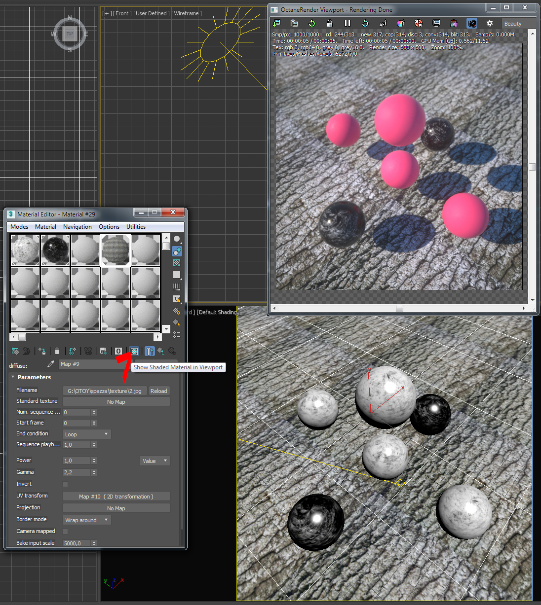

Octane materials don't display textures in the viewport. This makes it very difficult to get texture mapping work done.
This seems to be related to having an Octane Daylight in the scene, and using 'illuminate with scene lights' in the viewport settings.
paride4331
Posts: 3972
Hi Paulforgy,
I do not know if I have understood correctly, but it will work correctly using "show shaded material in viewport" as a screenshot.
Regards
Paride
senorpablo
Posts: 163
Joined: Sun Jun 28, 2015 2:52 am
paride4331 wrote:Hi Paulforgy,
Regards
Paride
Did you try it with 'Illuminate with Scene Lights'? In the image below, that's the only setting that has changed. It also happens to be the default setting for the 'High Quality' viewport setting. 'Standard Quality' viewport setting doesn't even render the sphere at all. There are serious issues with Octane materials and Octane lights(Daylight at least) in the viewport.
