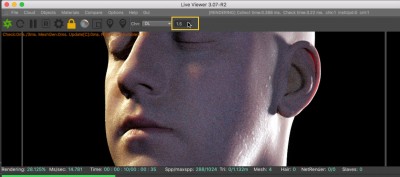

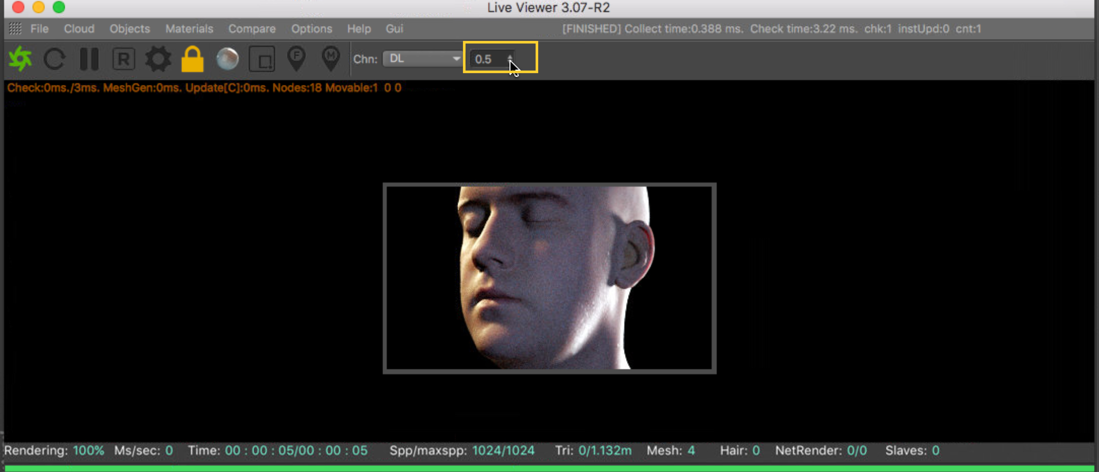

when you enable the Lock icon, a new view multiplier box should appear, to let you zoom in and out of the full frame buffer:
ciao beppe

Sweet! Thanks, beppe, I don't know how I've missed that for the last eight months!
