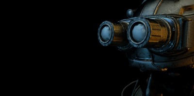

Hello everyone, I had a problem with the normal map, it is inverted when applied, if the uv is done with mirroring. In a standalone version it works exactly the same. Here is an example of how a normal map should work:
Marmoset
Marmoset

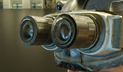

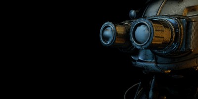

And an example of how she works in octane:
Octane
Octane

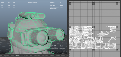

This is how the model uv looks:
UV
UV

What's standalone?
Getting inverse effect is normal if you used symmetry effect. Half part should have inverted normals. Please fix it.

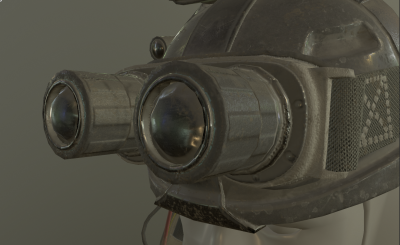

Good afternoon, how I can fix this problem without changing the uv? I received an alembic file and therefore I can not change the uv. This problem does not appear in the marmoset and redshift, so I think this is specifically a problem in Octane. I'm not the biggest fan of the redshift, but I want to use octane for rendering.
Redshift
Redshift

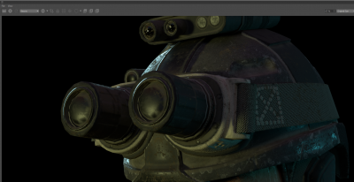

Hi, thanks for the advice, I found the truth a little more correct way, I need to invert the green channel in the normal map, and add it to the mirrored geometry part.
Bad_normal
Bad_normal
Invert_normal_parts
Invert_normal_parts
Invert_green_channel
