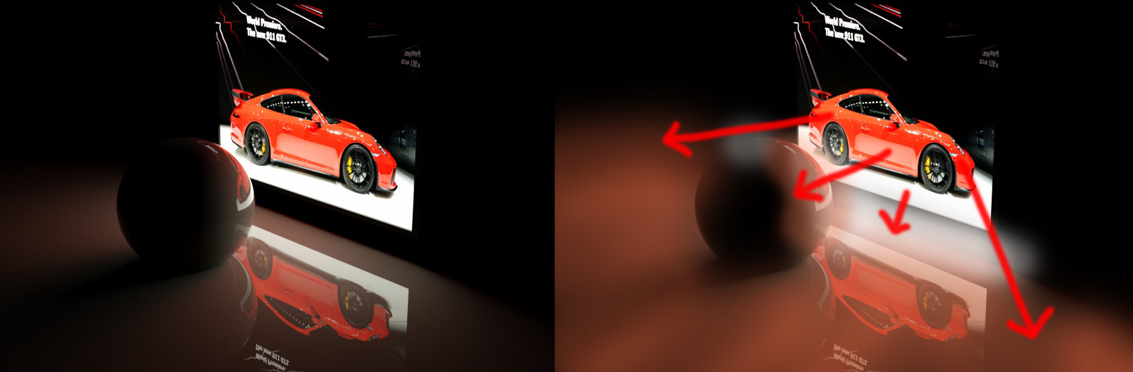

Hopefully with my new attachement you better understand my questions.
An example: I do have an automobile-press-conference-scene with the latest car in the focus. Behind the car there is a big LED-Wall. The scene is completly black except of a few spots and the illuminated LED-Wall.
The content of the LED-Wall (still or sequence) can be changed and the environment (car, floor, sphere) adapts on my content. So far so good.
My aim is to control the illumination of my environment (make it f.e. stronger) but the content of the LED-Wall should stay as it is (brightness).
Of course I can turn on the power of the emission but then the content is too overbrighten.
I hope now its better to understand.

I think he is asking that the TV visually stays the same (power 3), but the rest of the scene looks as if it's at power 10.
Might not be the most elegant, but could put another plane right in front of the tv with a new texture (using the same image). Set it's power up to 10 (or wherever you need it), but disable the camera visibility in the octane tag?

Ok, now I have understand, yes correct, one invisible emitter for lighting, and another one visible for the rendered light is always the best solution.
