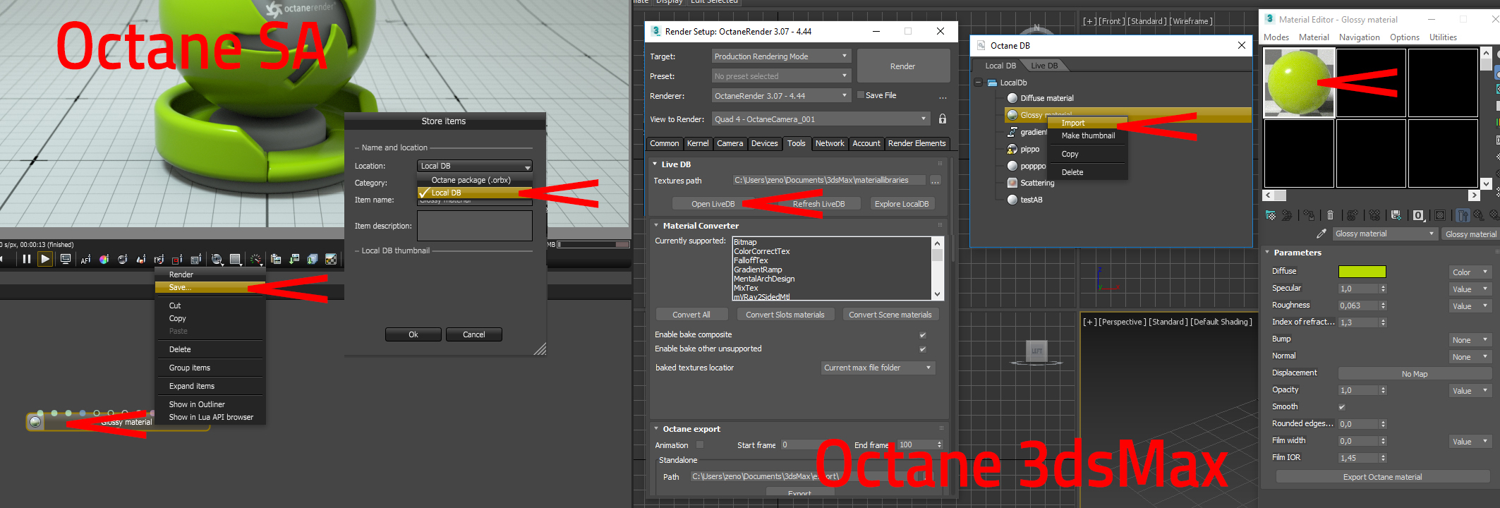

Hi emihich,
opening your scene in SA, you should save the shaders in your LocalDB and unpack your .orbx: File > Unpack Package.
then in 3dsMax, import geometry you unpacked and assign shaders (take them from 3dsMax LocalDB).
Regards
Paride

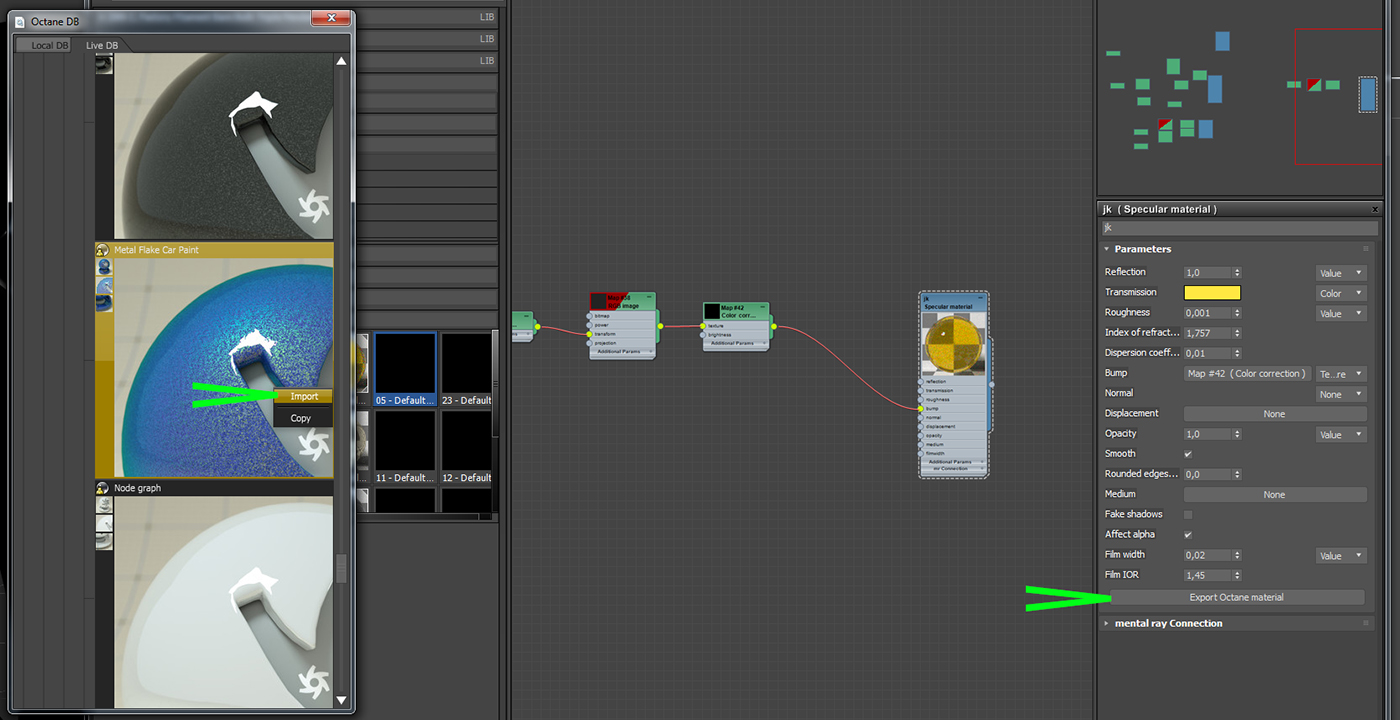

paride4331
Posts: 4001
Hi emihic,
I hope this will help you.
Regards
Paride
emihich
Posts: 189
Joined: Thu Sep 13, 2012 9:42 pm
Thank you so much !
it surely did help !!
