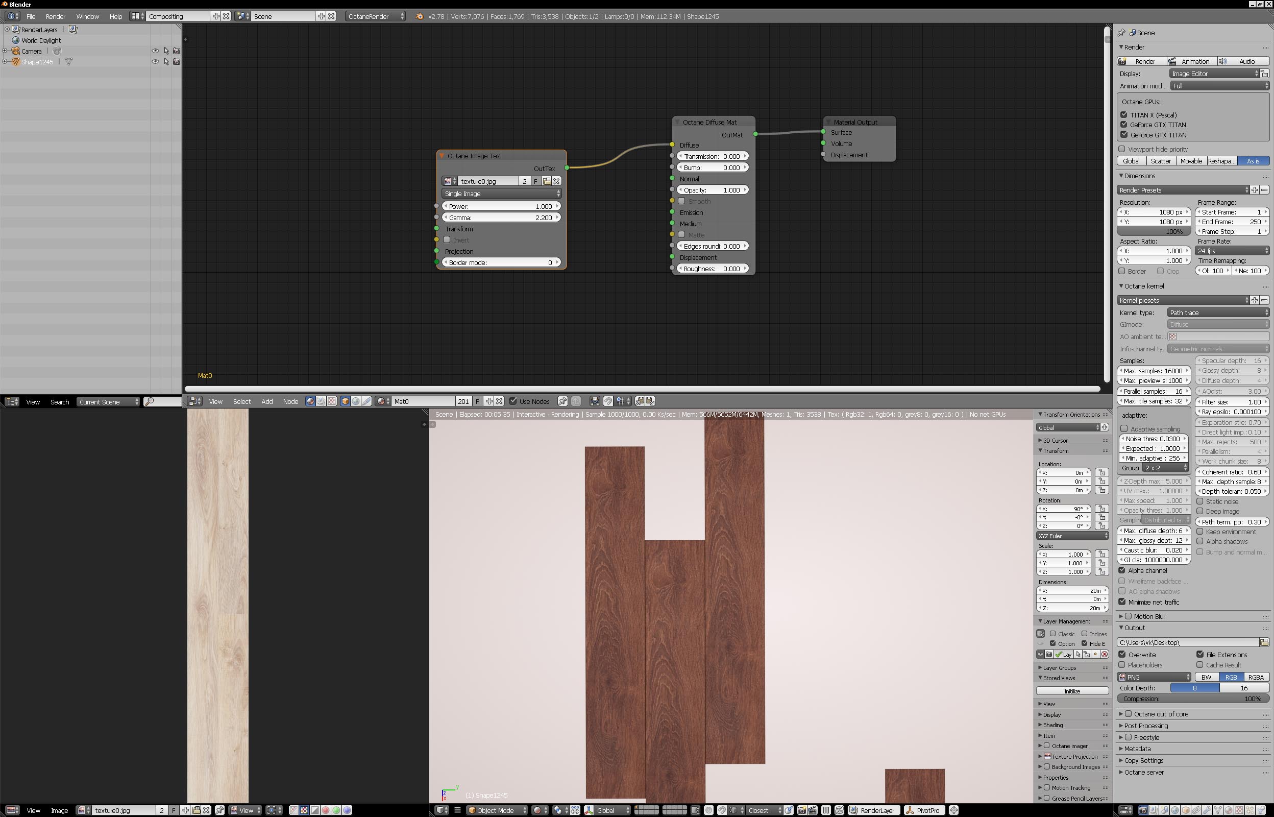

Octane PlugIn doesn't display the chosen Texture, when multiple Textures in different directories have the same filename.
See below:
Blender UV/Image Editor displays the correct chosen texture.
Octane renders a texture with the same filename from another directory.

Hi Aufwind,
This is an interesting bug. Thank you for the report. We will assess this, and see what we can do on our end to resolve the issue for our upcoming release.

Hi aufwind, thanks for your report. It will be fixed in 14.2.
