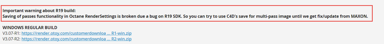

Do they render or can you actually save them (automatically through picture viewer, all other options are irrelevant when rendering animation)?
I am running C4D19.024 / 3.07 R2 and it works in the LV but you can't save it to a file. EXR creates a channel but it stays black or white, respective of the shadow pass.
Posts: 16068
Location: Türkiye
wecandance wrote:Do they render or can you actually save them (automatically through picture viewer, all other options are irrelevant when rendering animation)?
Did you read this warning?
