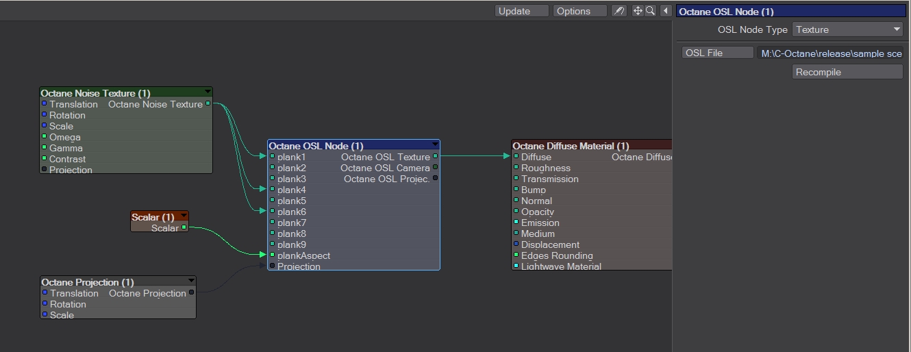

The Octane OSL feature is supported using the new "Octane OSL" LightWave node. The same LightWave node can be used for Texture, Camera or Projection OSL nodes. It works populating the node inputs from the OSL shader parameters after selecting it in the "OSL file" option. To control these OSL parameters, you can link any of the LightWave constant nodes (for the integer, scalar or vector type parameters), or Octane texture or projection nodes (for the texture or projection type parameters). The OSL string parameters are not supported yet. The LightWave plugin has the transformations nodes embedded in the "Octane Projection" node, so you don't need to define a transformation parameter in the shader.

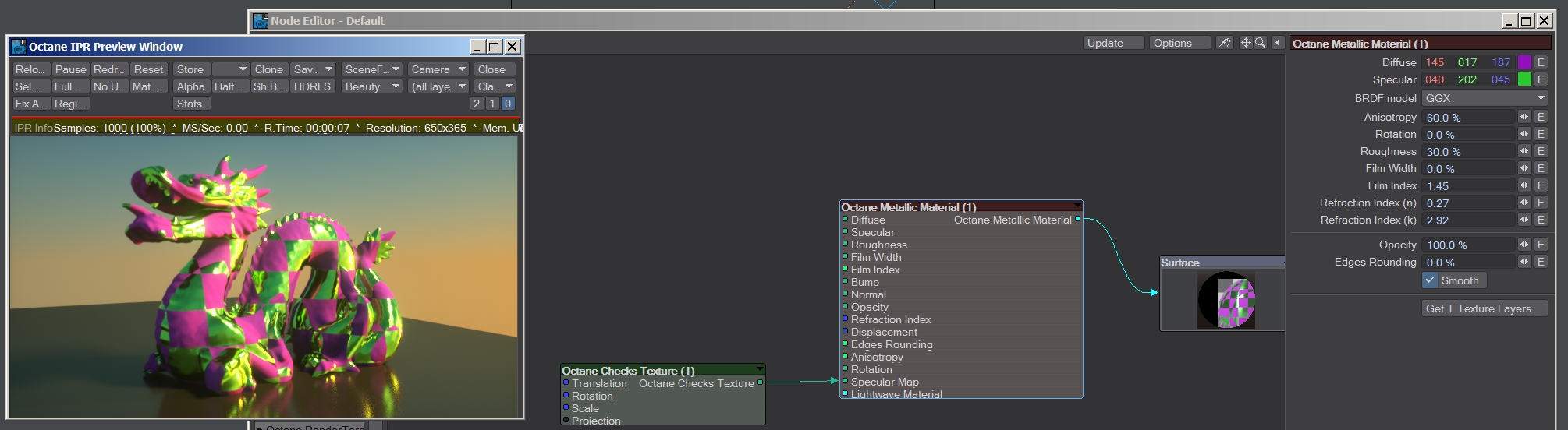

BorisGoreta wrote:Thanks a bunch !
Is that screenshot from LW 2018 ? Font is much nicer and bigger, more readable but there are some errors in font rendering.
In the node it says Outline thickness but in the node properties it says outline width.
Diffuse parameter in Metallic Material doesn't do anything.
Hi Boris,
The screenshot is from LW2015 in a 4k monitor with the workspace scaled. I'm afraid that LW2018 doesn't have big improvements related to the hi DPI monitors yet.
I've fixed the "Outline Width" typo. It should be "Outline Thickness", like in the Standalone.
The mixing between the diffuse and the specular parameters in the Metallic material is controlled linking a texture node the new "Specular Map" input. But, you are right, I've found a bug and this input is not working fine. I've fixed this critical issue for the next build, as you can see in the attached image.
Thanks for reporting these issues!
-Juanjo
