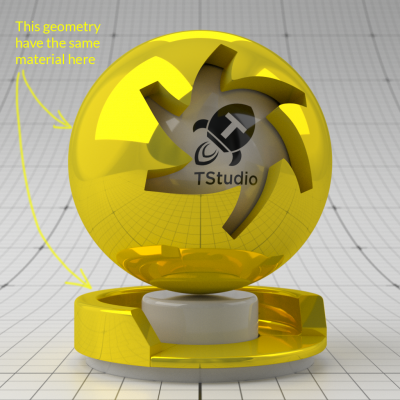

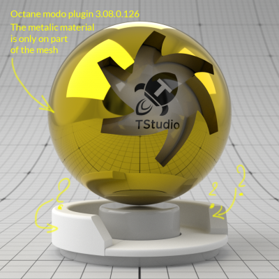

Hi Paul.
Thank you for the new plugin., I have test it,,, and I have found bug.
Octane can`t add Octane overide to every part of my mesh. See renders and provided scene.
Modo 902_SP3 (108604), octane plugin: 3.08.0.126.- Compiled with Octane 3.08 TEST 6.
Octane Error log:
tarted logging on 07.12.17 09:05:17
OctaneRender 3.08 TEST 6 (3080007)
Tried to access null node
Can't connect node 'Shaderball' (NT_MAT_GLOSSY, 00000001253F2BC0) to static pin 'input' (P_INPUT, type PT_MATERIAL) of node 'Material out' (NT_OUT_MATERIAL, 00000001253F7060)
Can't connect node 'Shaderball' (NT_MAT_METAL, 000000012554B460) to static pin 'input' (P_INPUT, type PT_MATERIAL) of node 'Material out' (NT_OUT_MATERIAL, 000000012554B7C0)
Octane Error log:

I can confirm that shader ball bug happens on MODO 11.2 This is a big one.

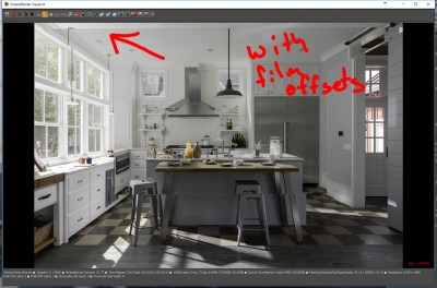

Edit - Looks like a camera projected texture (if the camera has film offsets) will render wrong.
I can also confirm that the two camera projection bugs now work properly. Thanks for that!

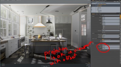

Looks like the film offset is being calculated twice or that something is reversed in the projected texture in the wall and ceiling plane.
If I have a camera with a film offset and it is the render camera as well as a projection camera (to project a texture on a plane)
I have the octane camera settings set to use modo film offsets
Basically the film offset seems to be shifted as if the math behind it was reversed.
render with camera offsets.
Found a hacky workaround that makes me think the behind the scenes math is reversed.
IF... I have a render camera that is also a projection camera with a film offset of:
X 700um
Y -1.3mm
I then duplicate the camera and use the duplicate camera only as the projection camera and then change the film offset to :
X 1.4mm
Y -2.6mm
Then the projection renders almost correctly in octane, it's only slightly off. In the modo viewport it looks wrong.
