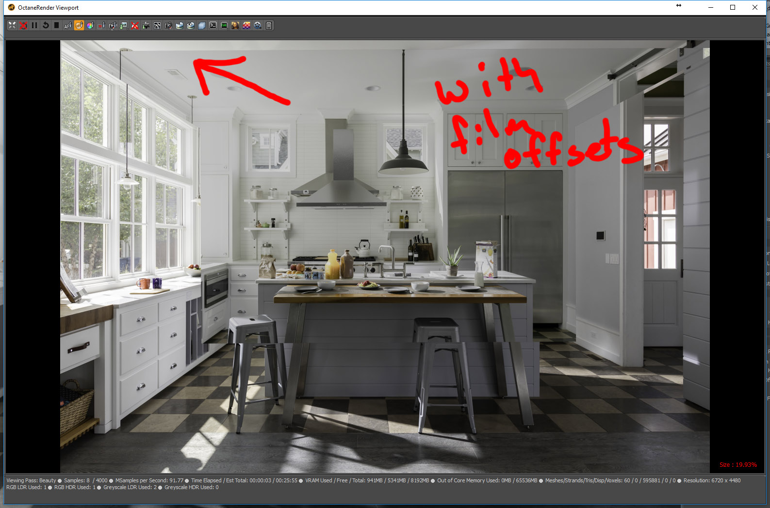

Edit - Looks like a camera projected texture (if the camera has film offsets) will render wrong.

Looks like the film offset is being calculated twice or that something is reversed in the projected texture in the wall and ceiling plane.
If I have a camera with a film offset and it is the render camera as well as a projection camera (to project a texture on a plane)
I have the octane camera settings set to use modo film offsets
Basically the film offset seems to be shifted as if the math behind it was reversed.

Found a hacky workaround that makes me think the behind the scenes math is reversed.
IF... I have a render camera that is also a projection camera with a film offset of:
X 700um
Y -1.3mm
I then duplicate the camera and use the duplicate camera only as the projection camera and then change the film offset to :
X 1.4mm
Y -2.6mm
Then the projection renders almost correctly in octane, it's only slightly off. In the modo viewport it looks wrong.
Can you please take a look at this? These projection bugs have put me a month behind on a big job.
