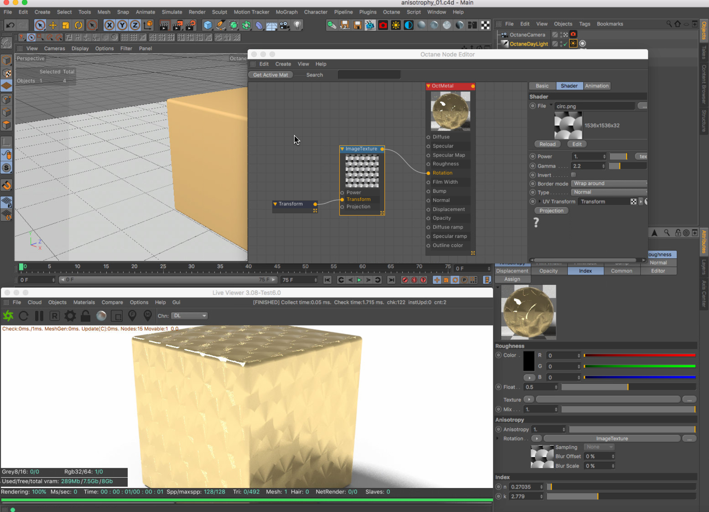

as already said by speltrong, you need a good amount of roughness to have a pronounced effect.
Here is a fast example:

mmm. interesting, I've placed the same parameters and map on my material and.. don't work.
Note that I've modify an old material made with old Octane version.
If I redo the material starting from zero it work.
Is possible that old materials cannot converted with the new features?
