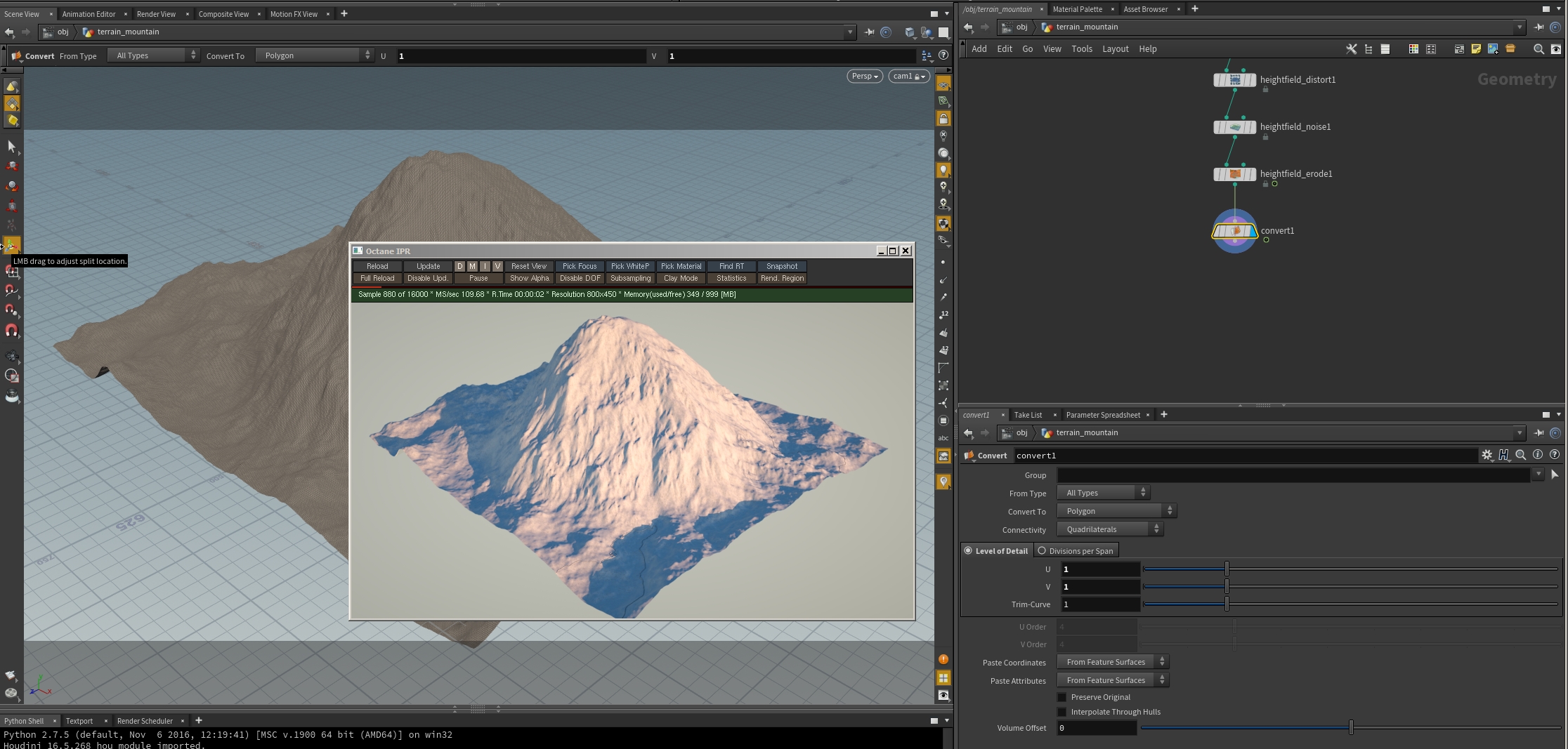

Also, remember that you could render the Houdini mountain objects adding a Convert SOP to convert it to a mesh object.

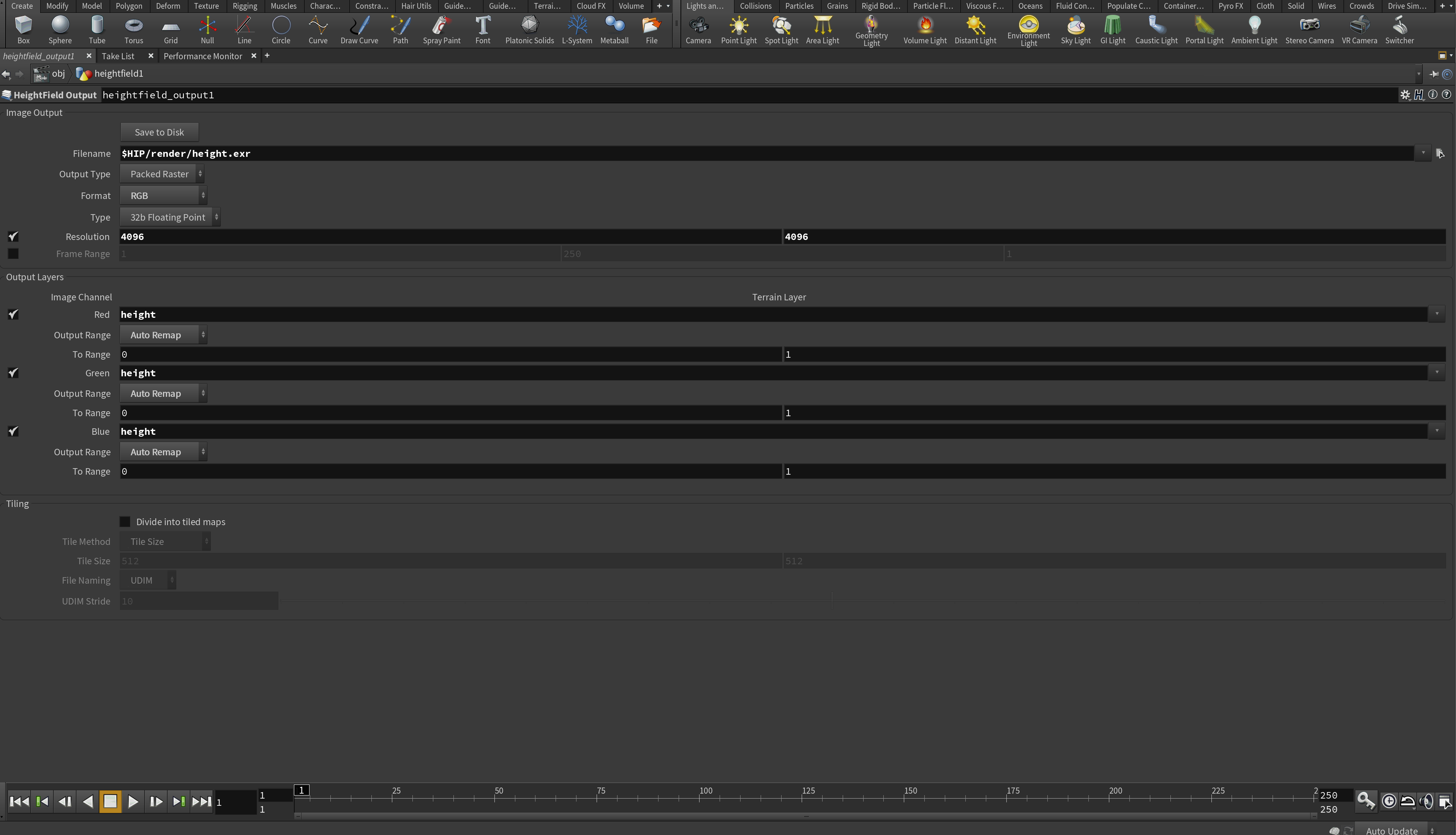

Hi thanks for the answer.
It's a RAW height map, you can only see B/W but they have a tons of informations between them, Mantra remap it automatically but not octane.
Converting in mesh, is not the solution to get the debris or the flow and their masks.
I finally found the solution, to convert with HeightField output node.
I had to put the height on each color with auto remap, and duplicate the node for each map (height, debris, flow, mask)
