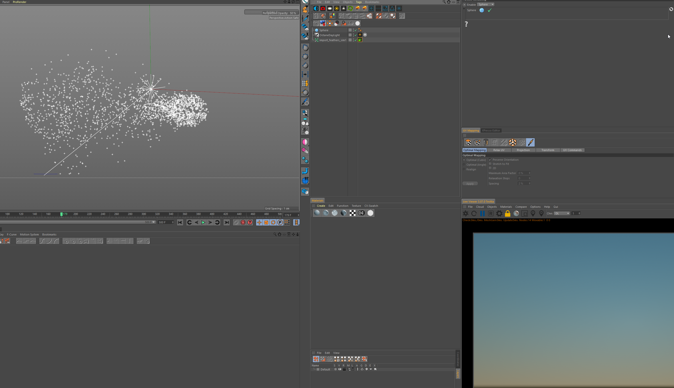

I'm trying to import particles simulation from Houdini via Alembic, and render them with Octane, without cloning geometry on the particles (Like we can do with xparticles or c4d particles combined with Octane tag)
1. Putting Octane tag on the Alembic object, and Enable particle rendering doesn't render the particles, See the screencap attached. Is there any way to solve it?

You cannot see particles just for adding object tags because it needs to be implemented in plugin. But I'll add this feature to scatter object not object tag. Just give me some time for 3.08 works. Also we don't need osl for coloring particles. It will be possible by instance_color node.
