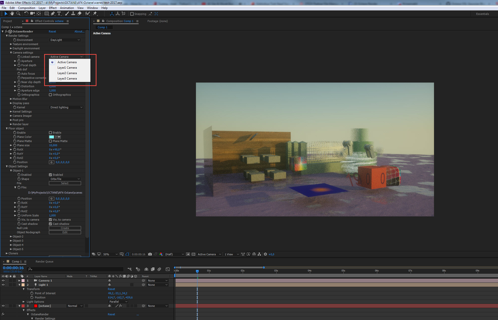

You have two options for camera.
To use AE camera or using camera from ORBX. See image.
You can navigate camera when you create an AE camera.
