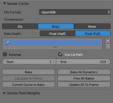

No problem here on OS X version.
smoke cache.jpg (37.25 KiB) Viewed 3110 times
