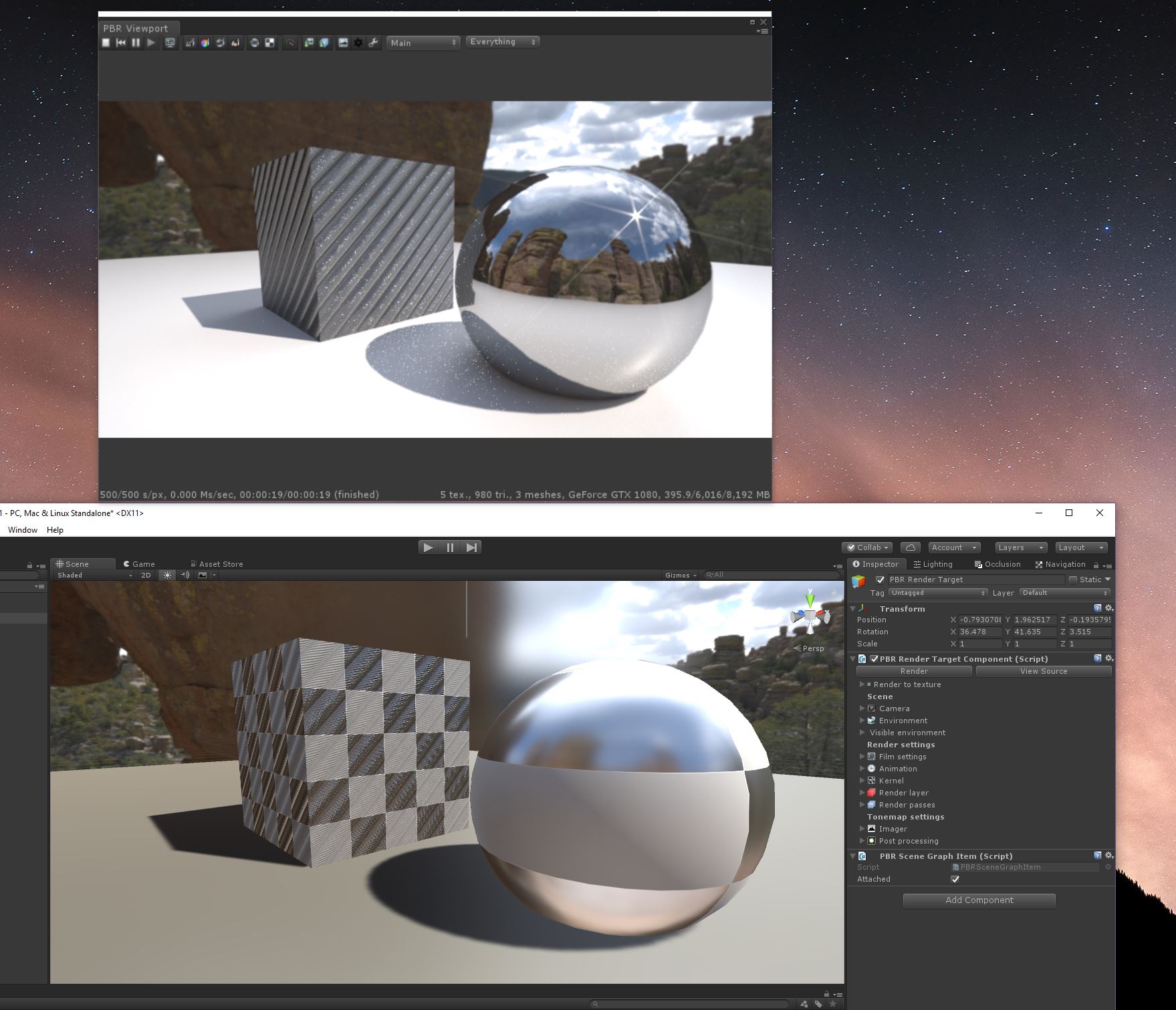

Testing with 32 bit TGA metalness with alpha, and tiff metalness with alpha. Gloss maps don't render.

Since you have a new build out, i though I would test this again.
I've discovered where the bug is with the metalness/gloss texure. You must set the metalness slider to 1 BEFORE you assign a texture to the metalness slot. Otherwise, it seems that the proper node network doesn't get built. Probably something you want to fix. I am available on skype: adamnerva if you need a demonstration of this. I will further test the materials.

adamnerva wrote:Since you have a new build out, i though I would test this again.
Good find, thanks for reporting it.
The issue has been fixed.
