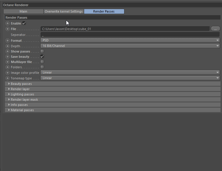

I may be early to the party trying to use R19 and 'C4D-V3.07-Test3a-win' build together, but I am not able to get Octane to write frames to disk.
The live viewer works, but nothing gets output.
Using the C4D save dialogue works, but not using the 'Render Passes' panel...
C4D R19.024

Thank you for the reply, but something is amiss.
I installed 'Octane-for-C4D-V3.07-Test6a-win' in R19, but still had no luck getting a frame to write to disk using Octane.
So, I deleted prefs and removed all other plugins and still no output. I have uninstalled R19 and reinstalled it and still cannot get a frame to write out.
Confused why I am having problems. R18 works as expected.

Check write privileges to location. Also try another path on hdd not on desktop place.

Thanks for the reply, Aoktar.
Privileges are working fine.
Tried writing to my work drive (D:) and still no output.
Running 'OctaneRender_3_07_test6_win' standalone and plugin version
