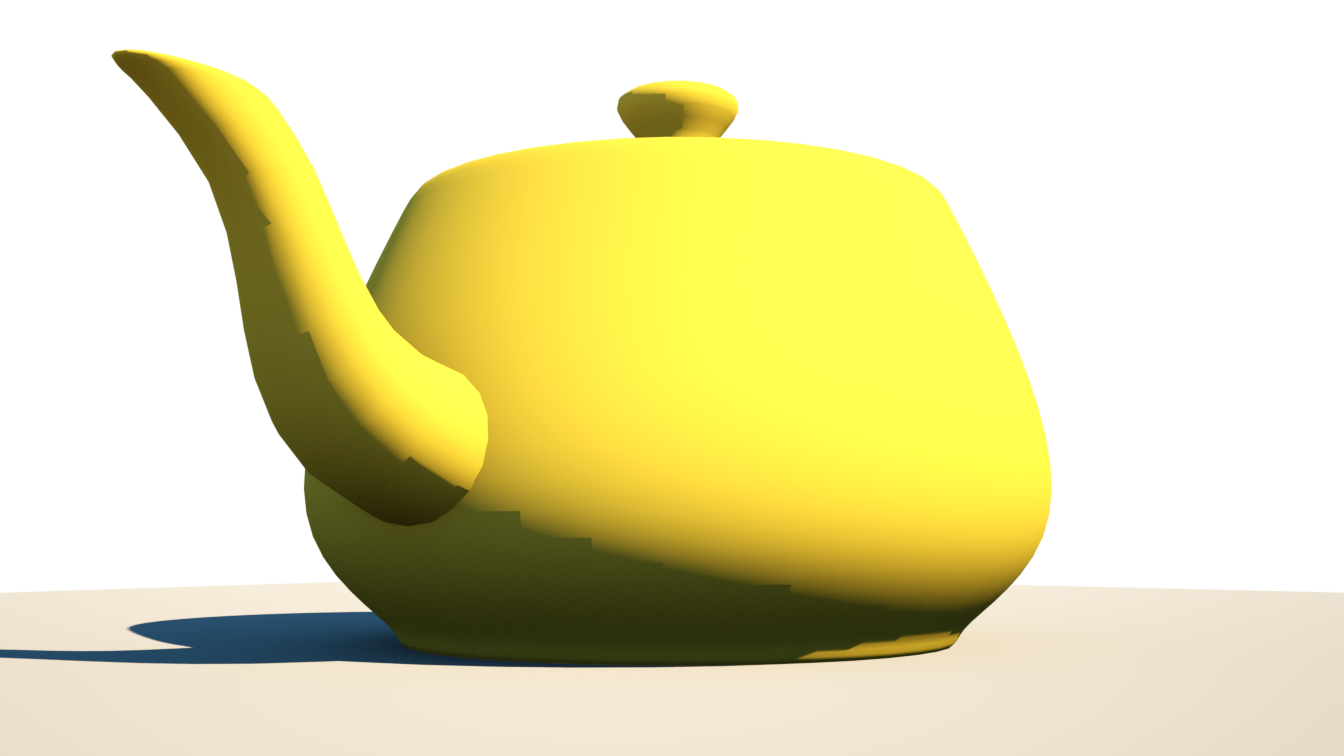

Mesh smoothing is still as bad as it was in 11.xx
Checkout the attachements. Blocky polygons are visible.
With the attached file you may replicate the bug in earlier post - crashing when changing material.
