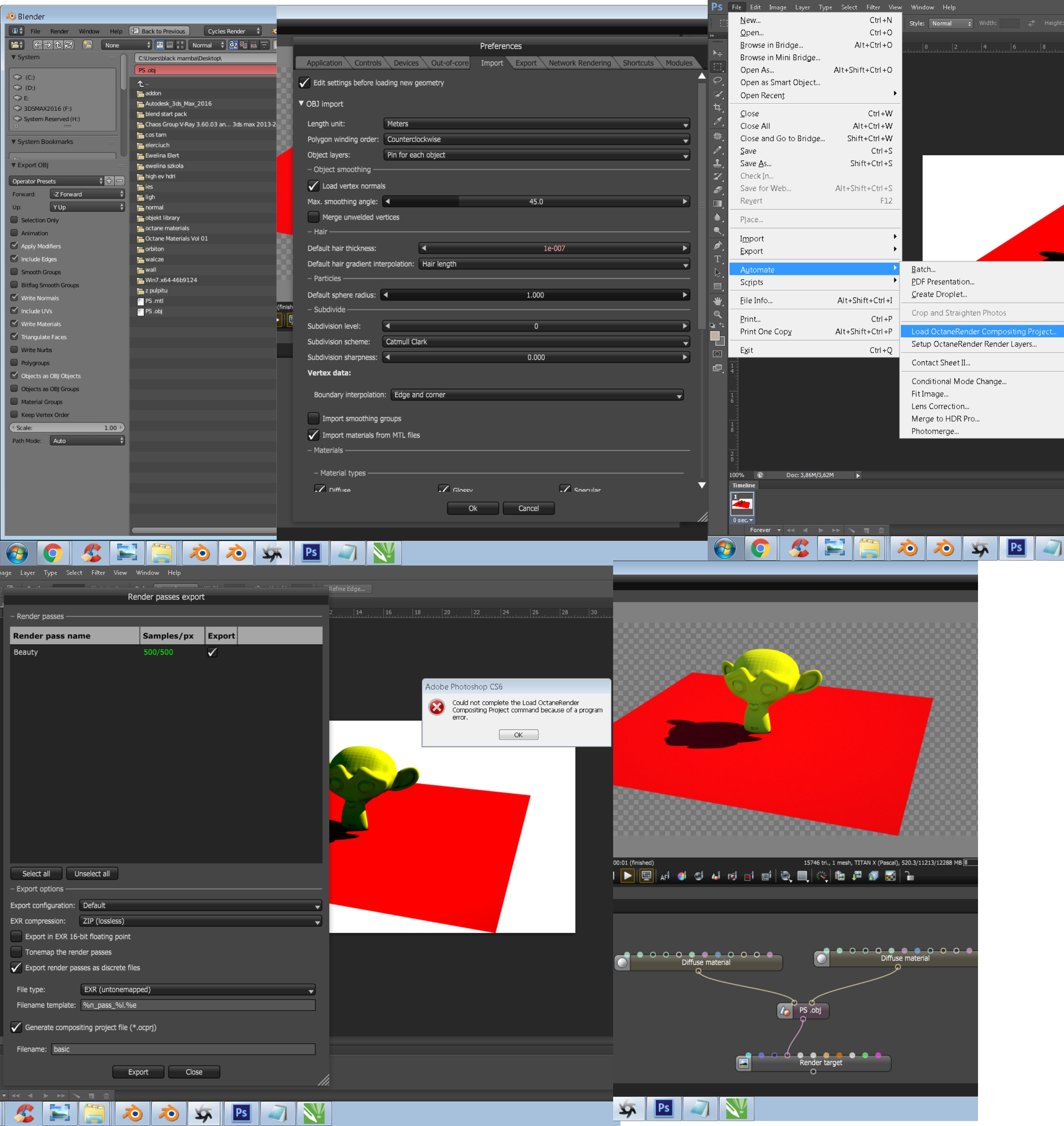

I'm having a difficulty with setting up an render layers, when loading .ocprj file to PS all layers are loading in different windows and afterwards i'm getting this error : ,,could not complete the setup octanerender render layers command becouse a program error.,,.
I have read manual but could not get right solution.
I`m using PS CS6 - OctaneRender Compositing Extension is up to date.
Tools i use : blender .obj export (is there export issue whith I should be aware of on in this very step ?)
And generally what to do next in to the
Octane Standalone to make it all work properly
how to setup nodes to create PS file with clean layers

thx for your quick reply, i know there has to be some easy solution in this matter, but i just cant find it. Could you send me proper example file i could analyze and learn from.

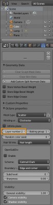

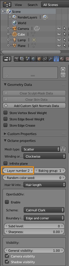

i think that you have not changed the layer id number of the monkey:
please, have a look at this poor example .blend and .orbx scenes:
Archive.zip
(86.69 KiB) Downloaded 534 times
