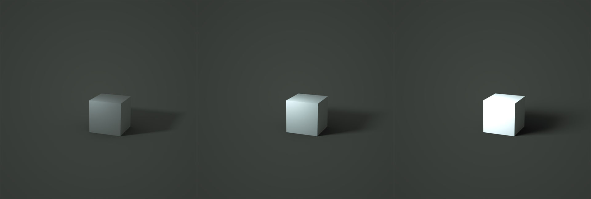

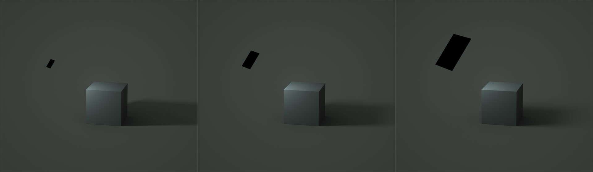

I made a quick comparison between Poser and DAZ (both the same scene, only the size of the emitter is changed)
Poser (scale independant, physically correct)
DAZ (brightness depends on emitter mesh scale)

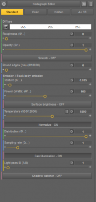

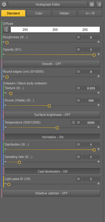

Emitter values are in both applications and all cases the same:
