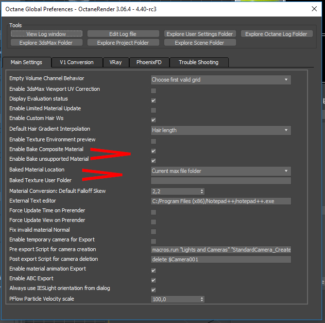

Hi mytherapy,mojave wrote:Yes this is possible in 3dsMax, here from the docs:mytherapy wrote:Ok, thanks for the quick reply.
Is it possible to bake in 3ds Max using render to texture? Are there any tutorials/videos on that?
https://docs.otoy.com/3DSMaxH/3DSMaxPlu ... Baking.htm
If you are using material converter (Render Setup > tools > open Octane global preferences ), you can use automatic bake texture tool
and find the baked textures in the assigned folders.
Regards
Paride

Paride4331 - are you talking about this as part of the rendering workflow in 3ds max?If you are using material converter (Render Setup > tools > open Octane global preferences), you can use automatic bake texture tool
