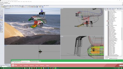

Im trying to match up the colour, lighting, perspective etc of a spaceship sitting infront of a photography I took and are using as a background image.
I am using either
viewport properties/wallpaper and loading the photo there or
Display options/viewport settings and loading it there. Not sure which is better or maybe they are the same??
I am able to successfully export the image using the alpha image transparency and put it together in photoshop.
However, I am finding it very hard to make sure the colour and lighting and perspective etc match up.
Its a very long winded process to take the image out into photoshop, load it and copy paste ect into the image, then scale and review it to realise that there is not enough orange from the sun etc to match the background.
I would love to be able to do a rendering in the OCTANE RENDER VIEWPORT that show the background image behind it.

Hi - this is a limitation with Octane - in that it does not same the background image with the PNG. However it is worth considering that if you use a background plate, the lighting is never going to match the rendered geometry, so it is not going to be as realistic as if you took a 360 degree lat/long shot of the beach. To do exact matched of the background plate, have a look at http://photomatch.phantomtechnology.nl/.
