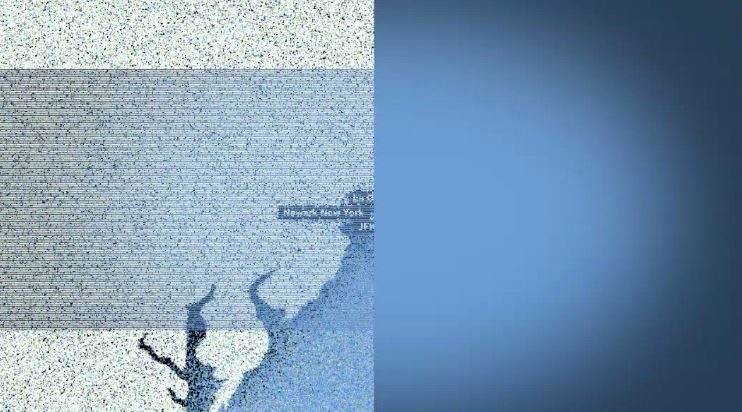

I did a complete re-render last night while away, and I discovered a new issue..
A lot of frames are coming out like this. Flickering like crazy. There is no problem as long as the camera is moving, but once it is still, the flickering like this occurs.
I have the latest GeForce driver and the latest build of Octane as found in the sticky thread.
