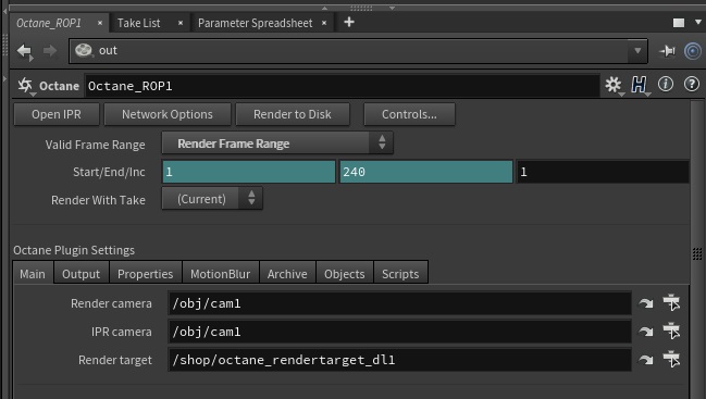

Render and animation should be easy from the Octane ROP node. You only need to select the "Render Frame Range" valid frame range option, and press the "Render to Disk" button.

By default, the MPlay preview while rendering to disk is overwriting the MPlay image to save memory CPU memory while rendering large sequences, but there is an option in the Octane ROP to disable this behavior. In any case, while rendering to disk, if you have the output file options enabled, you should have the rendered files on your disk. You must configure the output path/filename using the $F token to set the file frame numbering, like in Mantra, for example $HIP/render/filename-$F.exr

Octane (or Houdini from an ROP node) can't output animation files. You need to save the individual frames and compile the animation using other software. You could try also to export an animation file from MPlay, although to be honest, I've never had any luck with this feature. To have the full animation in MPlay you need to disable the "Overwrite Mplay frame" option.

Just wanted to add in case someone arrives here via google like I did, 'full scene reload' must be selected on the Octane ROP also. It seems really obvious I know but had me caught out for a minute :oops:
